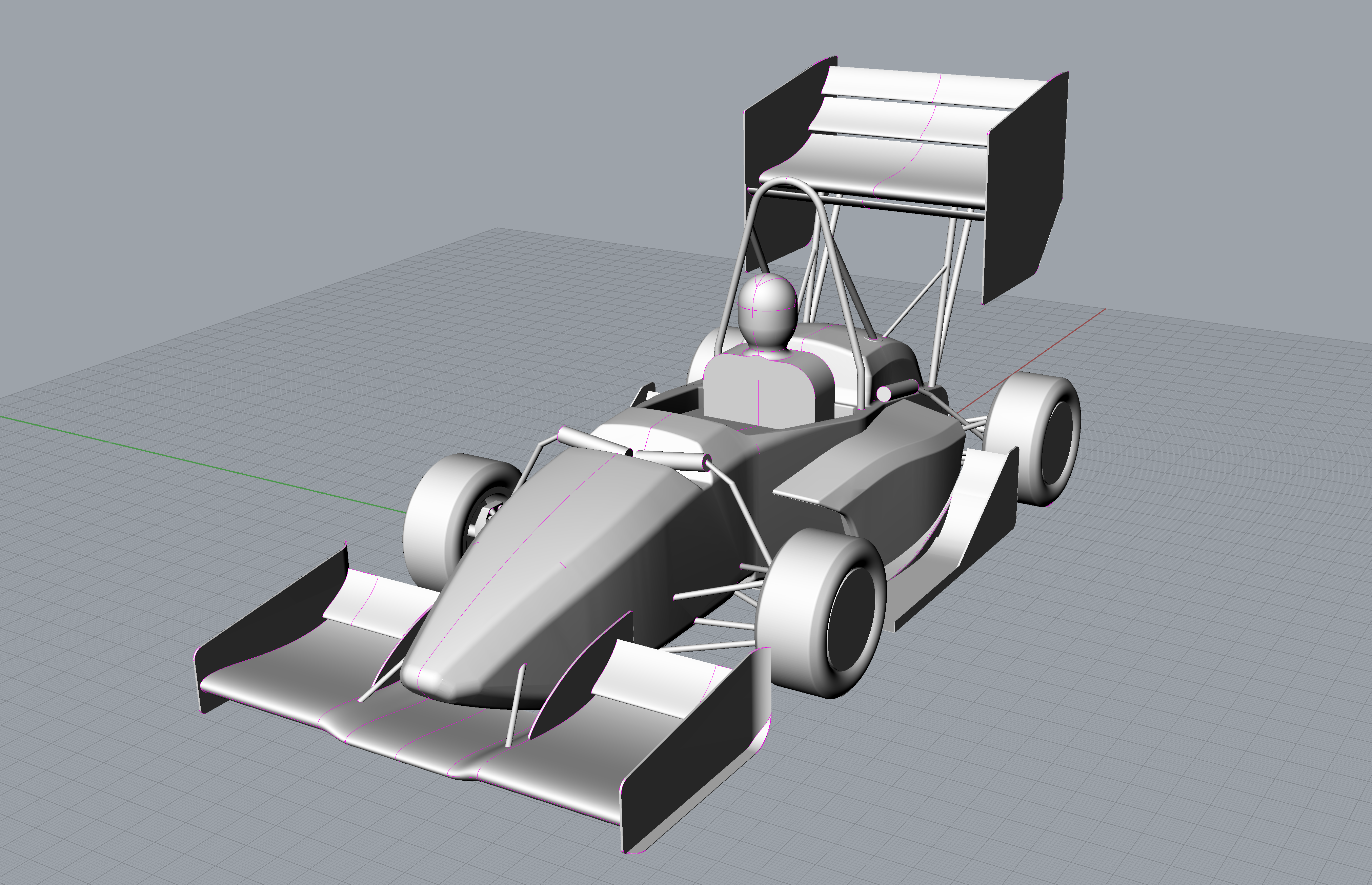

A mesh is giving an error. The event log shows: unexpected te for cell zone.
What does this means?

Hi @jur ,
I checked your geometry and found some naked edges which make your model non-watertight.
Naked Edges in pink (or purple?)
Yosuke
Thanks Yosuke.
How can i make these edges watertight?
Jeroen
