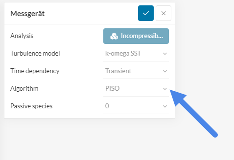

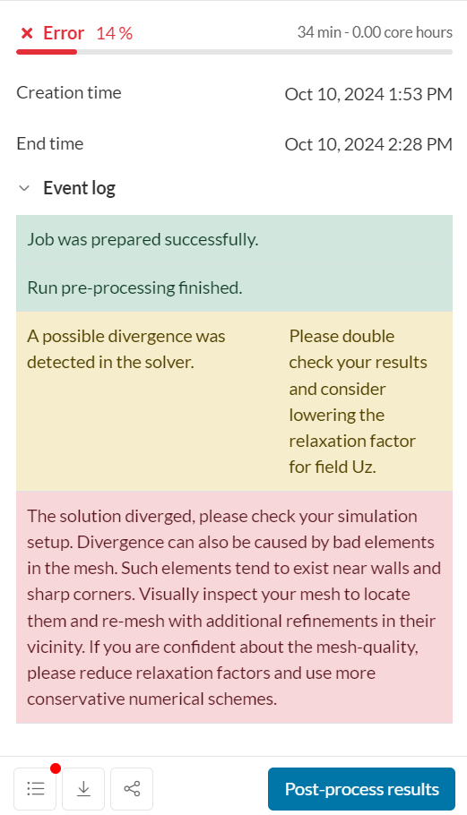

I am new to CFD and am trying to simulate a sub-equipment. I believe the simulation must be transient because I want to gather information about potential VIV (vortex-induced vibrations). I have already run a similar simulation in SimScale, it was steady state and was successful. Now, I’ve made some changes and am attempting a new simulation, but I ve got errors, which you can see in the attached picture. It would be really helpful if someone could suggest a solution or provide tips on how to continue the simulation.

Setting up a transient analysis is usually not an easy and straightforward task like setting up a steady state one. The mesh needs to be very well behaved and the maximum timestep/Courant number carefully chosen. For such a large domain (9.4M cells), a transient analysis would also consume lots of resources and not be feasible to my evaluation.
You should also use PIMPLE instead of PISO to be able to work with larger Courant numbers:
