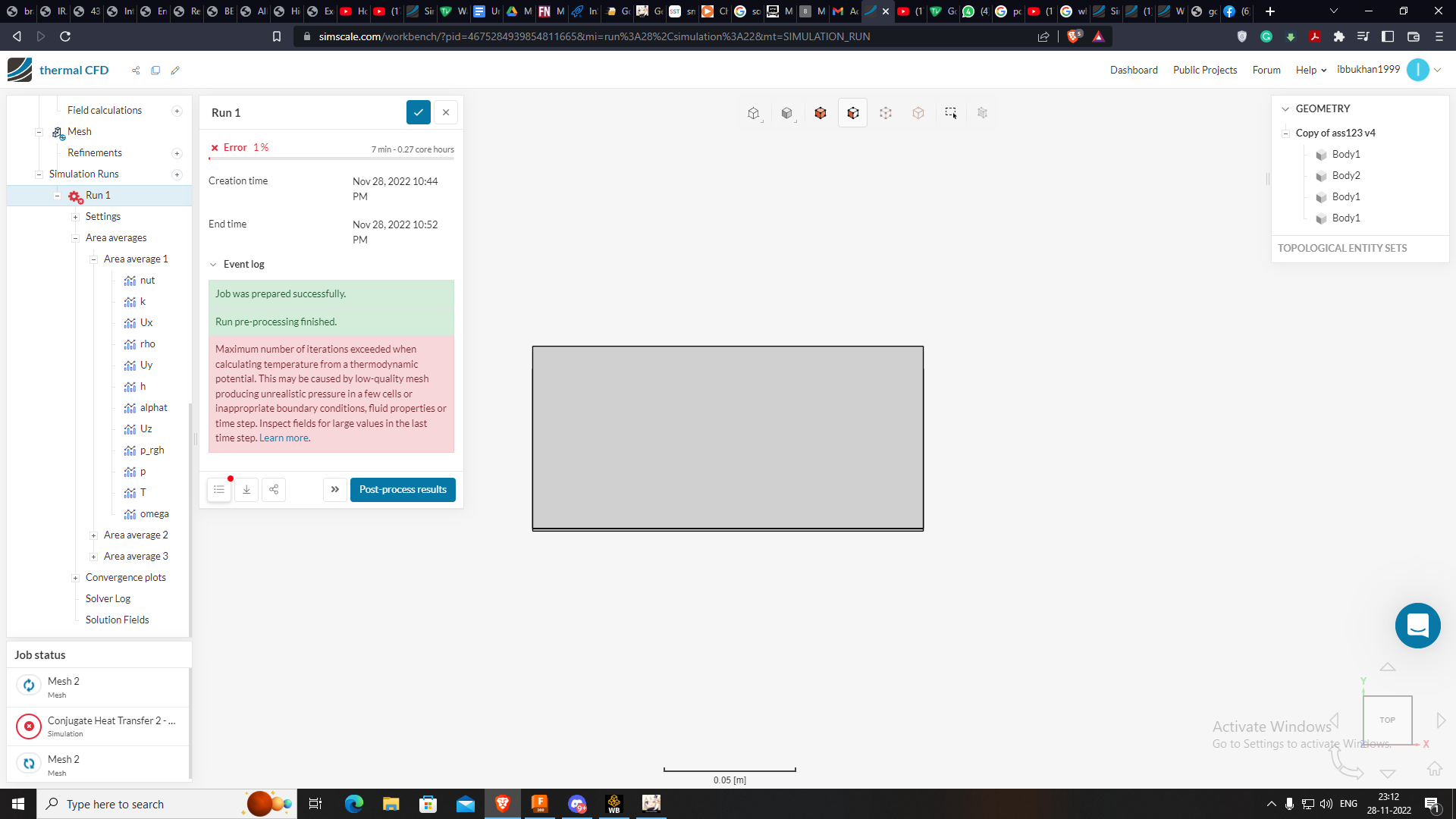

Please share the link to the failed simulation run to have a look at it and try to spot the issue.

Hi, I can see that you have not created a flow region to assign the air material. Right now, it seems like the air is assigned to the enclosure. Is this the intention?
no, I have created that outside box as a flow region
You need to create a flow region. Please check this page for instructions:

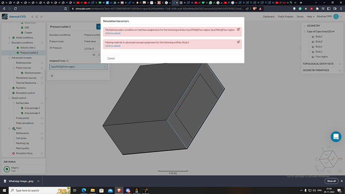

Hi, the error messages are very descriptive:
“Multiple boundary conditions or interface assignments…” The signaled faces have multiple boundary conditions or are under one boundary condition and interface at the same time.
“Missing material…” You need to assign a material to this part.
