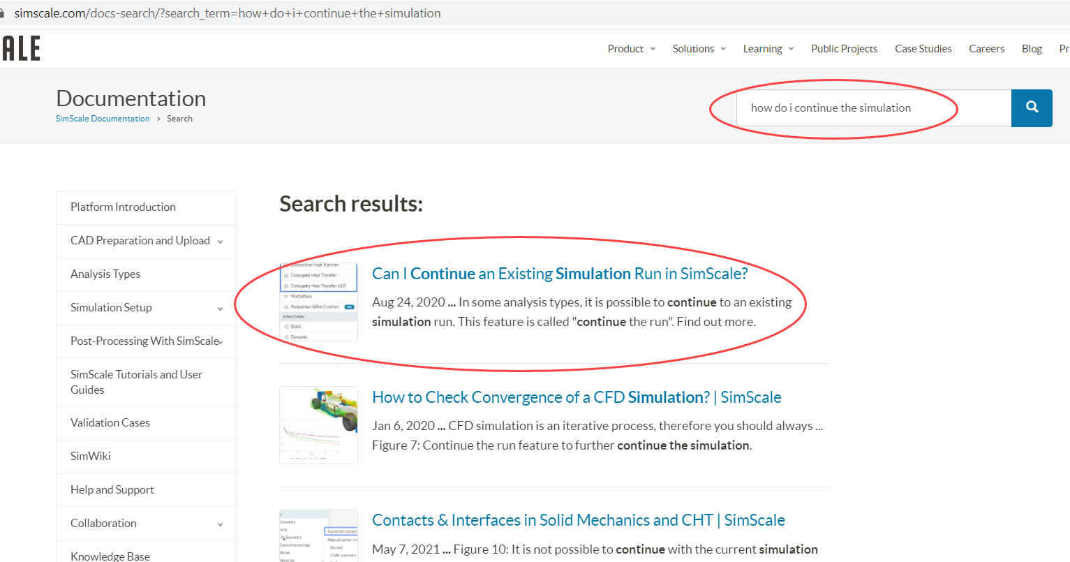

If you mean how to restart a simulation that was stopped with the same mesh & settings, then that is possible. This article contains more information: Can I Continue an Existing Simulation Run in SimScale?
PS: the answer to most of these questions are readily available in the documentation, with a simple search. Using your exact terms, you would find the same article that I just linked :slight_smile:

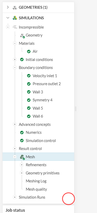

Hi, the previous mesh was too large (36M elements). The current mesh has around 2M elements and should run.
To rerun the simulation, simply click on the + button around here, and start a new operation.

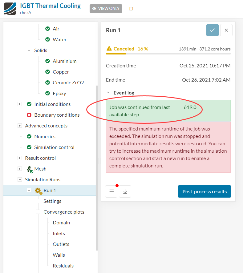

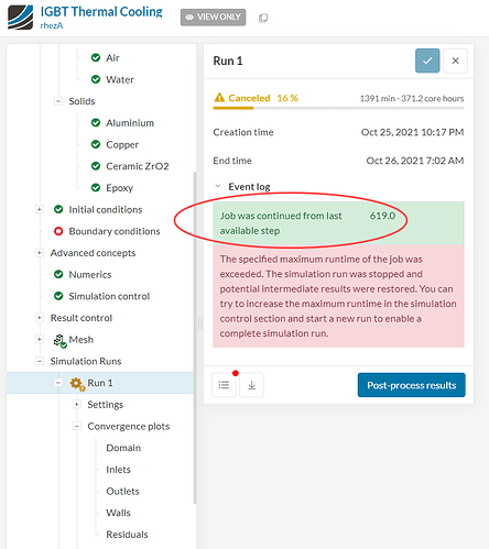

I had try that, but when I do that the simulation start over from 0%.
The 1st run is on 25% and when I re-run it got canceled on 16%. Please check my project " https://www.simscale.com/workbench/?pid=2565597783074117495&mi=run%3A21%2Csimulation%3A14&mt=SIMULATION_RUN".
Hi @rhezA,
You will find the details under the event log:

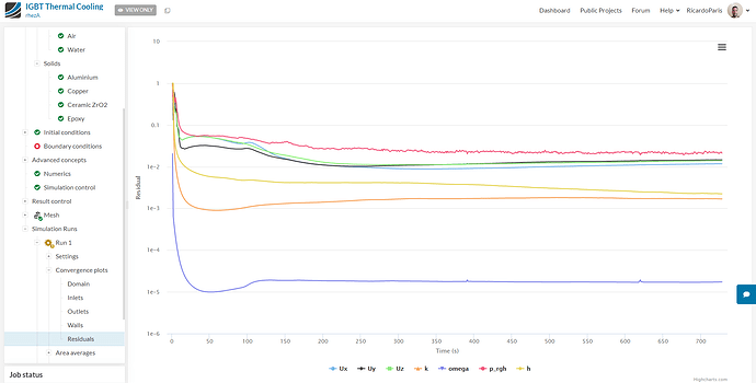

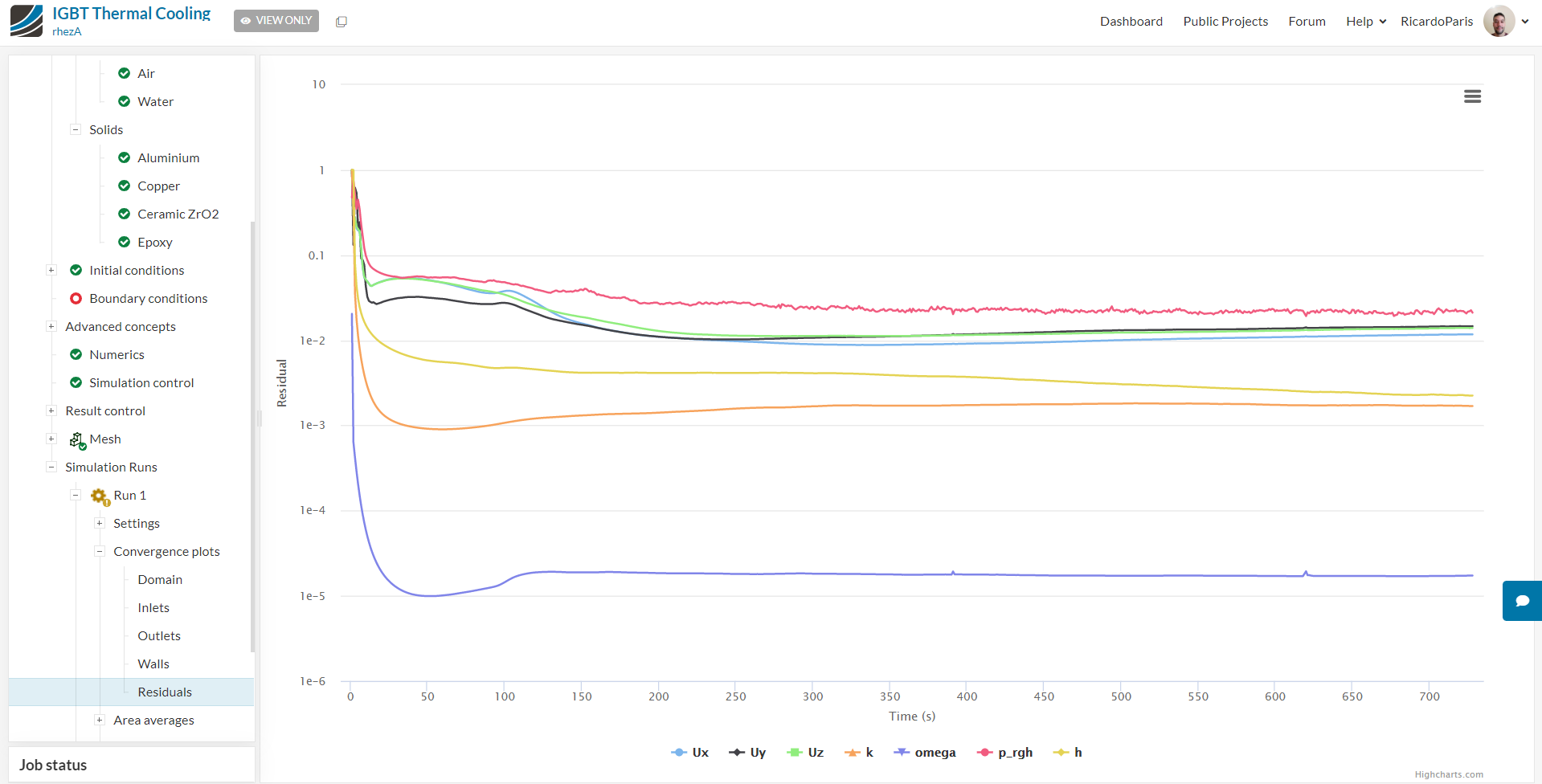

By checking the convergence plots, you will notice that the simulation resumed from where it stopped (i.e. iteration 619):
