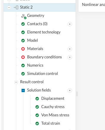

  1. By default certain “Solution fields” are enabled. This will make sure you have atleast some results written out.
  2. Please keep them enabled to get some results.
Here is a sample run I am running with some solution fields, this should have the results option enabled.https://www.simscale.com/workbench/?pid=1955733462846468674&mi=run%3A48%2Csimulation%3A3&mt=SIMULATION_RUN
