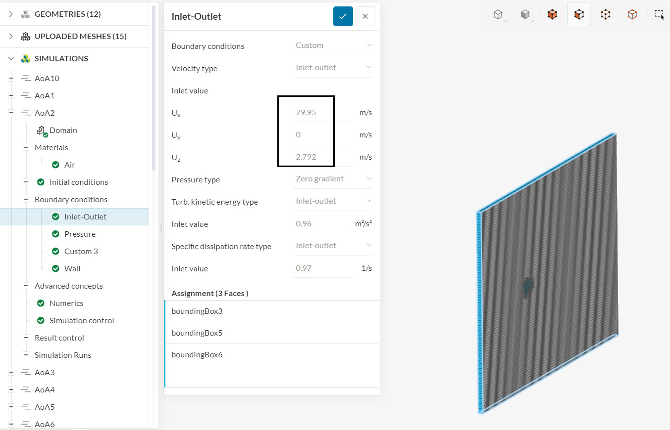

In short, the velocity inlets should be defined with an angle (like this):
So if you are interested in an AoA of 10 degrees, you can simply calculate 15cos 10 degrees and 15sin 10 degrees - these are the values that should be input.
This tutorial may be helpful in your case. The setup of your simulation would be quite similar, except for the analysis type (yours would be incompressible, given the velocities).
