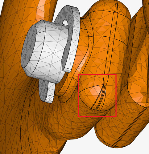

Hello, and thank you for using the Forum! Following error is caused usually due to low mesh quality. There are two ways to resolve this error. First one is increasing the mesh quality further which will require more work, but will result in more accurate results. In order to improve mesh quality, you can either use local, region refinement zones or modify some of the problematic parts in your geometry. One of the examples, below is a region with a mesh quality lower than other parts. These little faces can be deleted, or united so they will form a single face. This will increase the mesh quality significantly.
Please have a look at this page to have more information on how to detect bad quality elements in your mesh and improve mesh quality.
