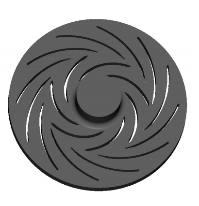

Pumps are designed to increase the pressure of a fluid. One of the key design parameters, in the pump design, is the rotor-stater interaction. Much of the optimization costs can be saved by using the CFD tools for such studies. This project investigates the flow interaction between impeller and the vaned diffuser.

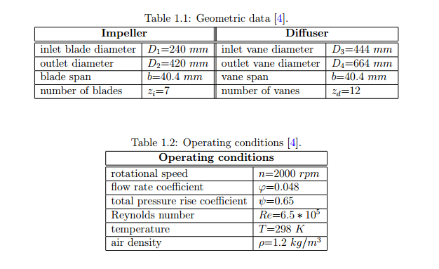

Input Data
The impeller geometry can be formed by using the data below. Non critical parameters can be assumed for this project.
