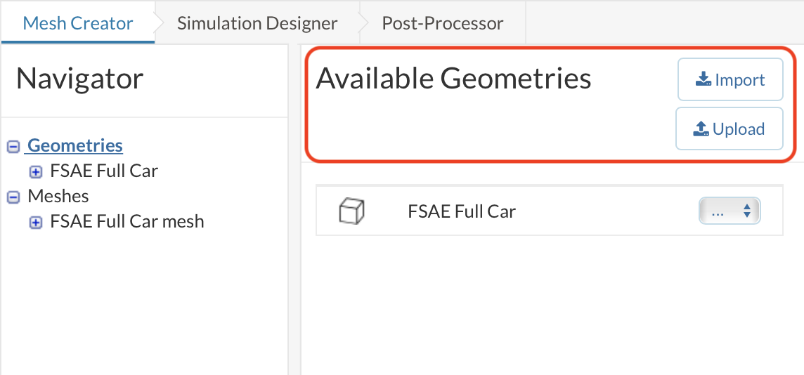

Hi Im wondering how I can import my own models into Simscale, do you have tutorials or references?
Thank you
Hi @czhang!
Happy that you are so engaged! You go to the Mesh Creator and click on Geometries. You can either Import models from OnShape or Upload your own geometries. Allowed files are .IGES, .STEP & .STL.
Hope that helps!
Cheers and happy SimScaling!
