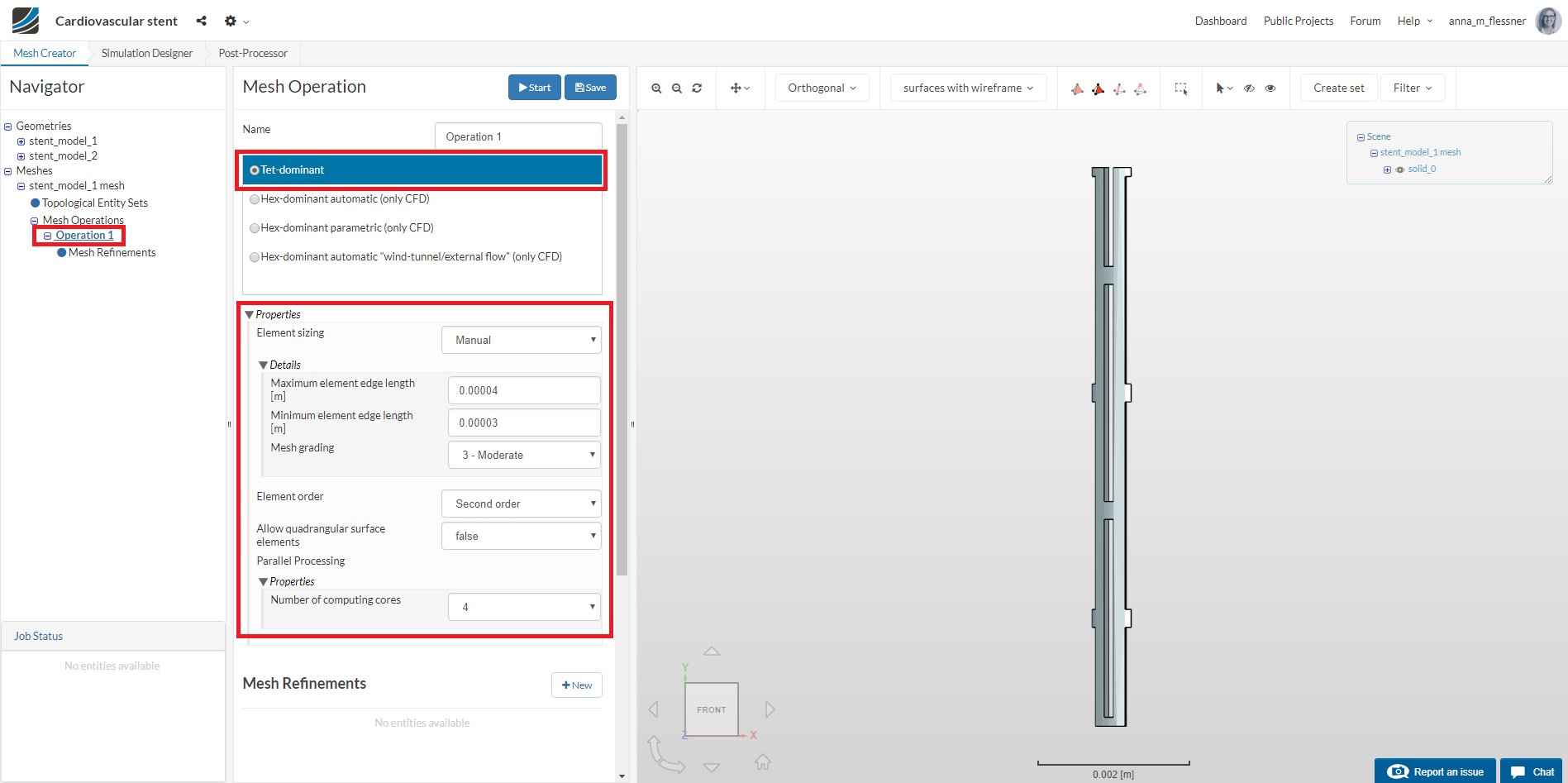

In the Mesh Creator tab, click on the geometry stent_model_1
Then, click on New Mesh button in the options panel.
Select Tet-dominant
  • Element sizing Manual
  • Specify the maximum and minimum edge length to be 0.00004 and 0.00003 respectively
  • Mesh grading 3-Moderate
  • Element order Second order
  • Number of computing cores 4
Click on Save and then Start to start the meshing job. The meshing job will take a few minutes to finish and show the status as Finished once done.

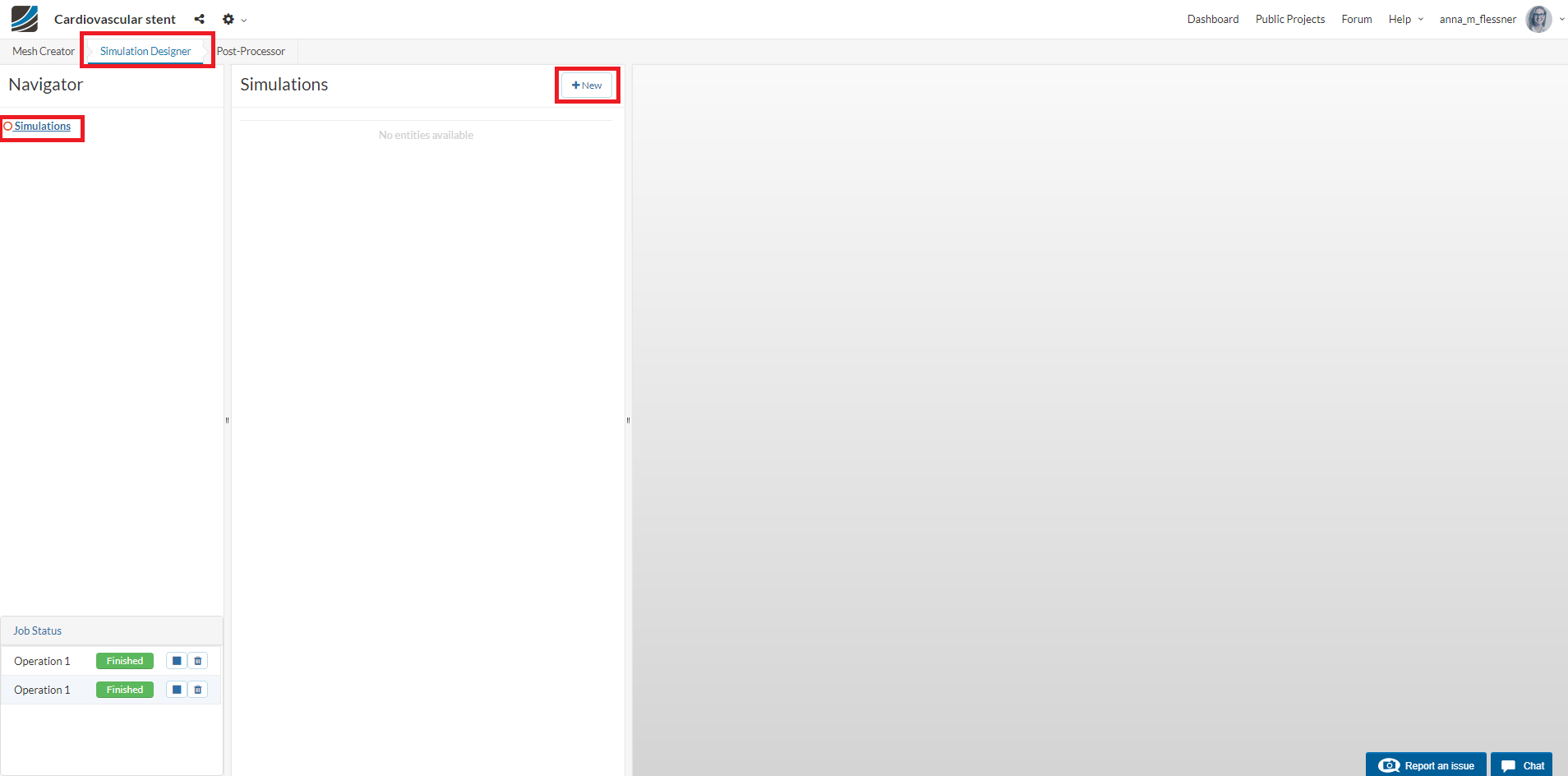

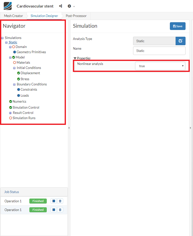

For setting up the simulation switch to the Simulation Designer tab and click +New to create new simulation.
A pop-up will appear to select the Analysis Type.

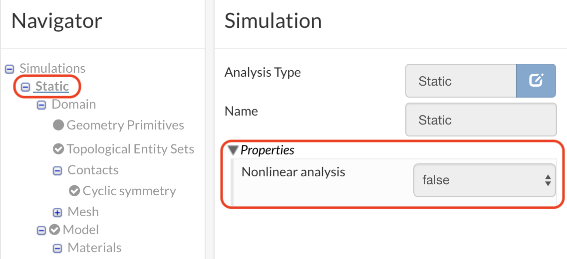

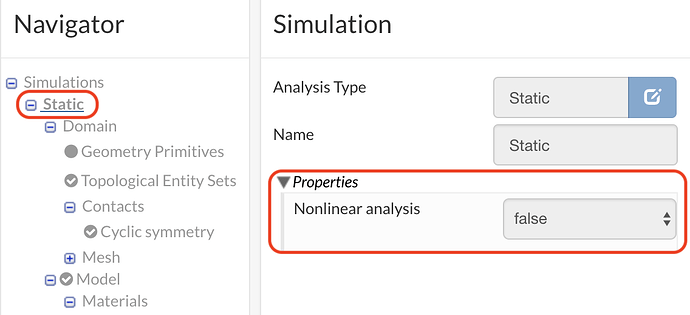

Since our load will be static, select the analysis type Static under Solid mechanics. And click Save.
There deformation will be large including material nonlinearity, thus set Nonlinear Analysis to true
After saving, the Navigator now looks as shown below. Here the Navigator entries in red must be completed.

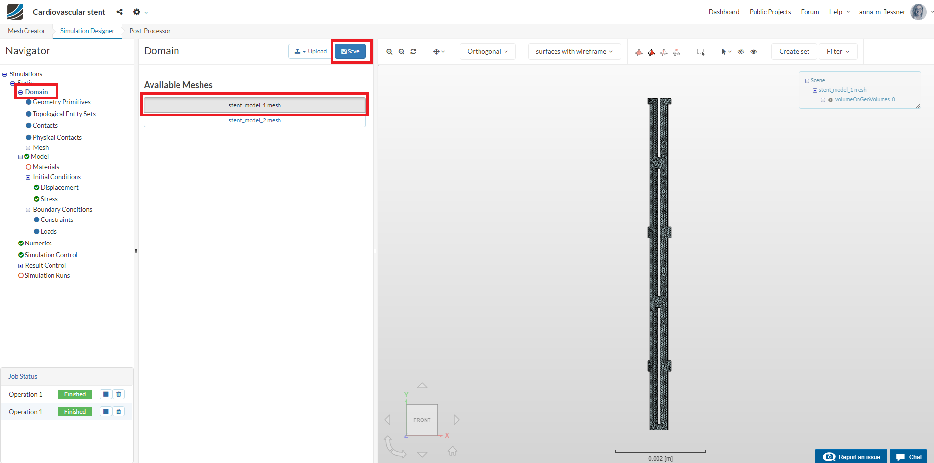

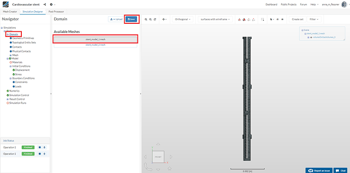

Click on the Domain item in the Navigator and select the first mesh that you created. Click Save. The mesh will then automatically load in the viewer.
Next change the render mode to Surfaces in the top viewer bar to interact with the mesh more easily.

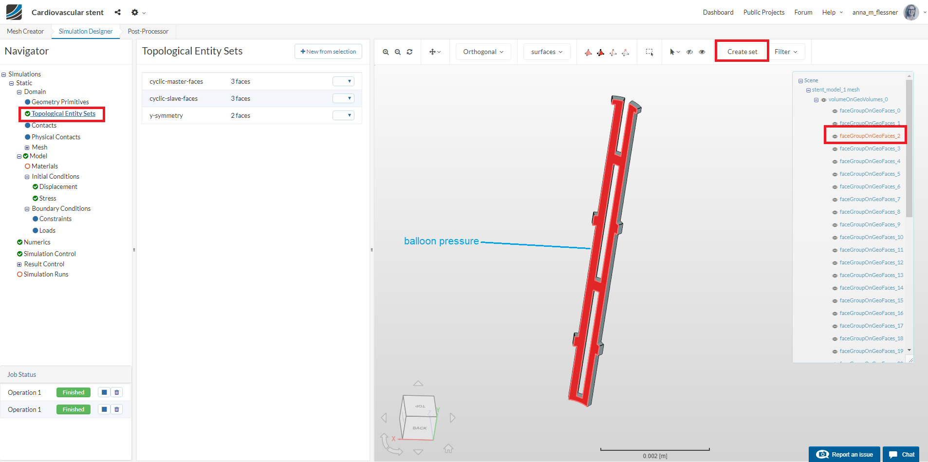

Topological Entity Sets

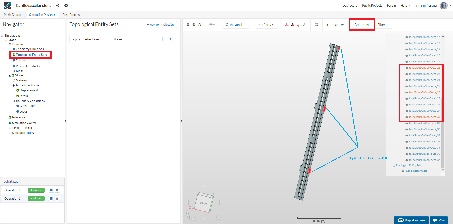

We will create topological entity sets to make things easier later when we are setting up our boundary conditions. The topological entity sets will be based on the figure below which explains all the boundary and loading conditions.

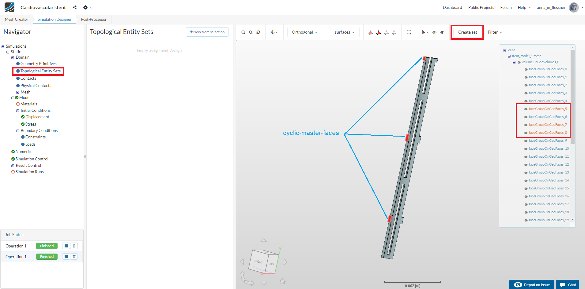

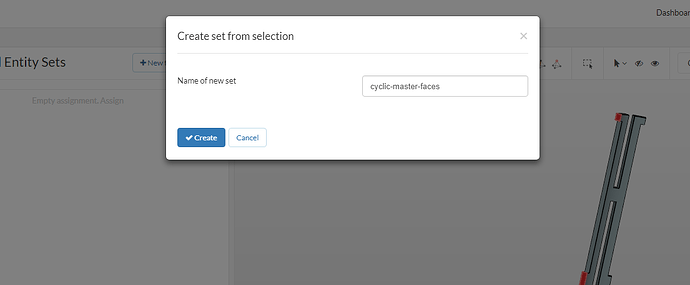

We will create total of 4 topological entity sets as shown below:

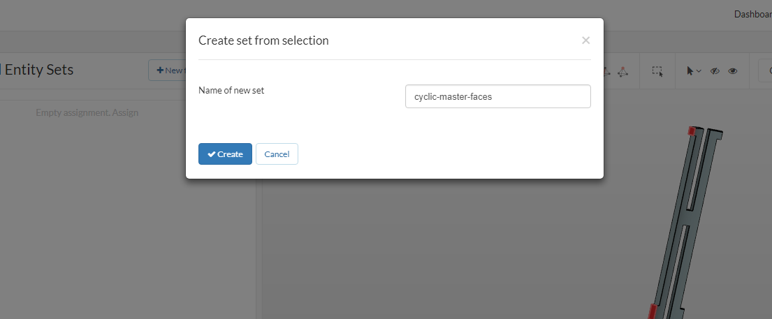

cyclic-master-faces
Click on the faces on the geometry as shown in the figure below and then click Create set in the top viewer bar.
Give the set a reasonable name e.g. cyclic-master-faces and click Create to create the set.
cyclic-slave-faces
Follow the same steps as above but this time select the faces on the opposite side of the geometry as shown in the figure below.
Give the set a reasonable name e.g. cyclic-slave-faces and click Create to create the set.

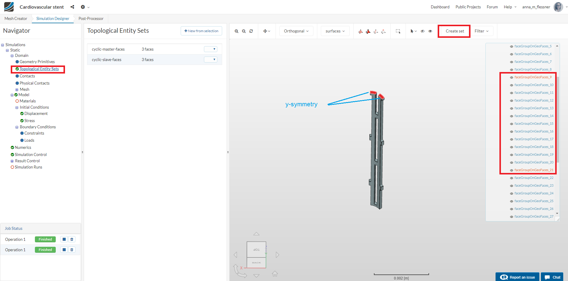

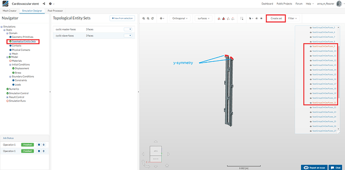

y-symmetry
Following the same steps as above, this time select the upper two faces of the geometry as shown in the figure below.
Give the set a reasonable name e.g. y-symmetry and click Create to create the set.

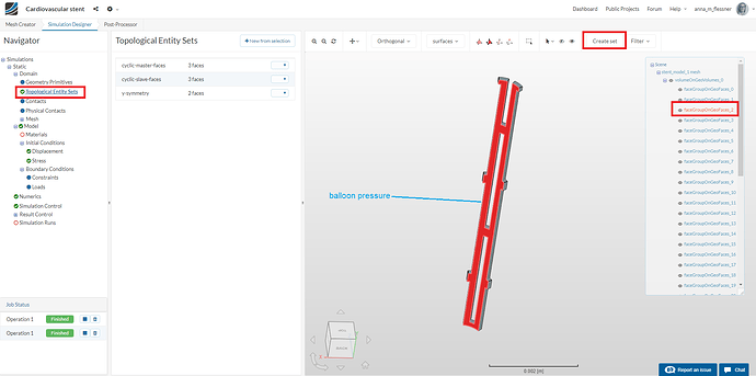

balloon-pressure
For the last set, select the inner face of the geometry as shown in the figure below.
Give the set a reasonable name e.g.balloon-pressure and click Create to create the set.
The table below shows the number of faces selected for each topological entity set:

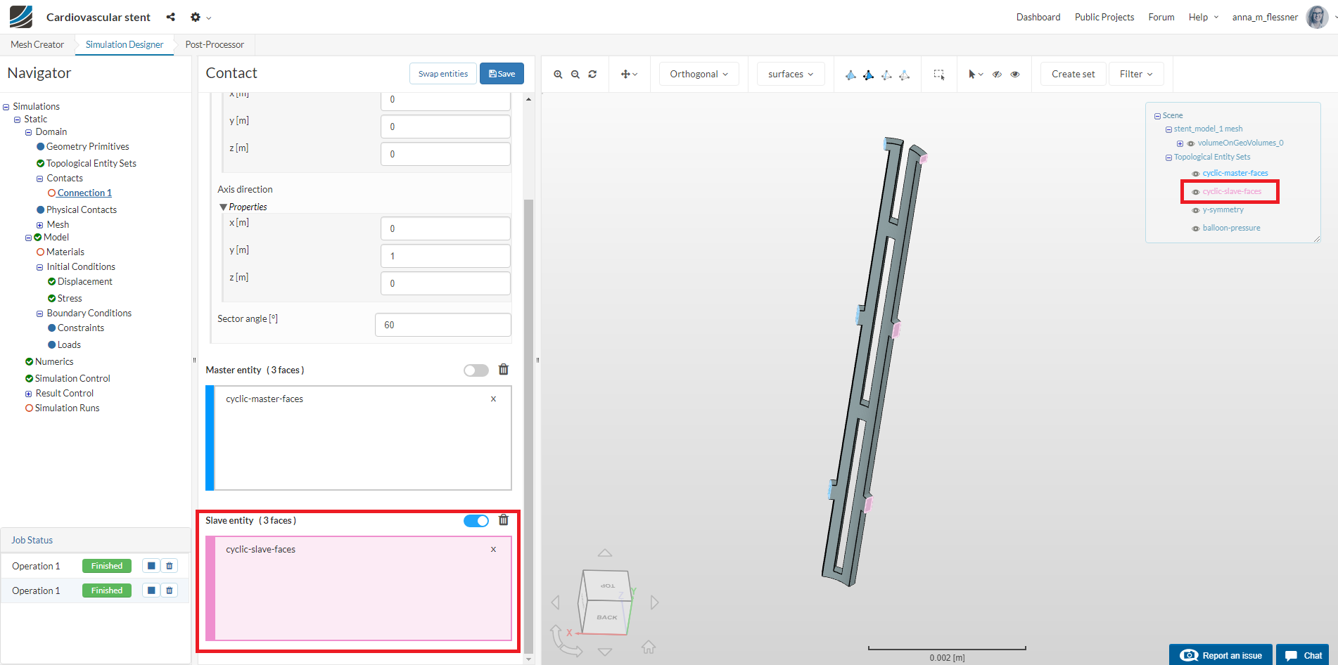

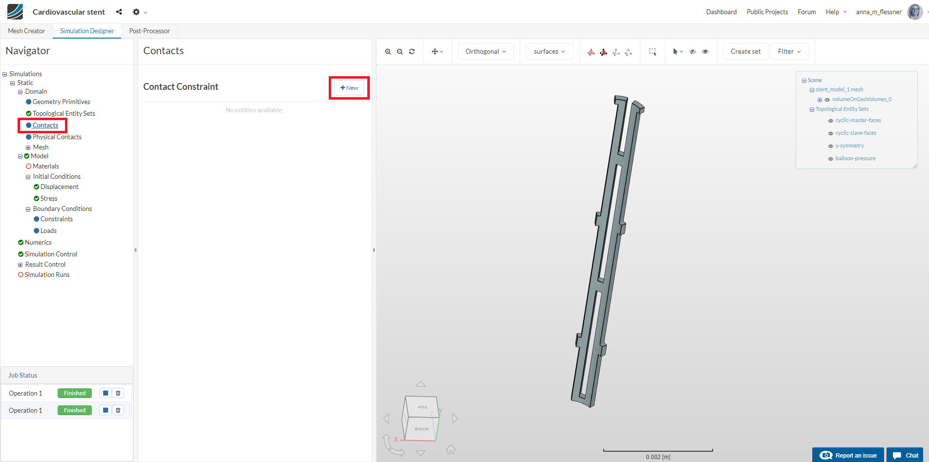

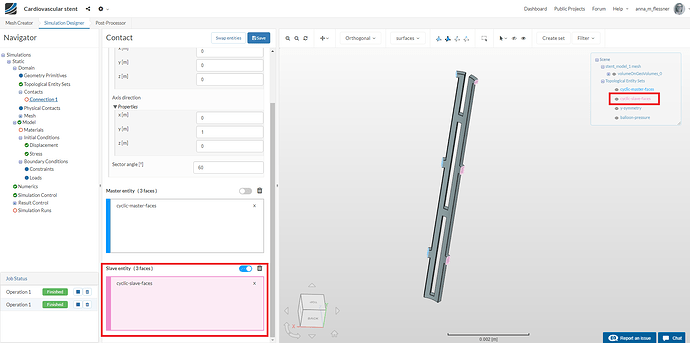

Once the topological entity sets definition is done, we will proceed to define the cyclic symmetry which we require since we have taken only a portion of our geometry.
For more information on cyclic symmetry, please see the Cyclic symmetry documentation

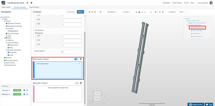

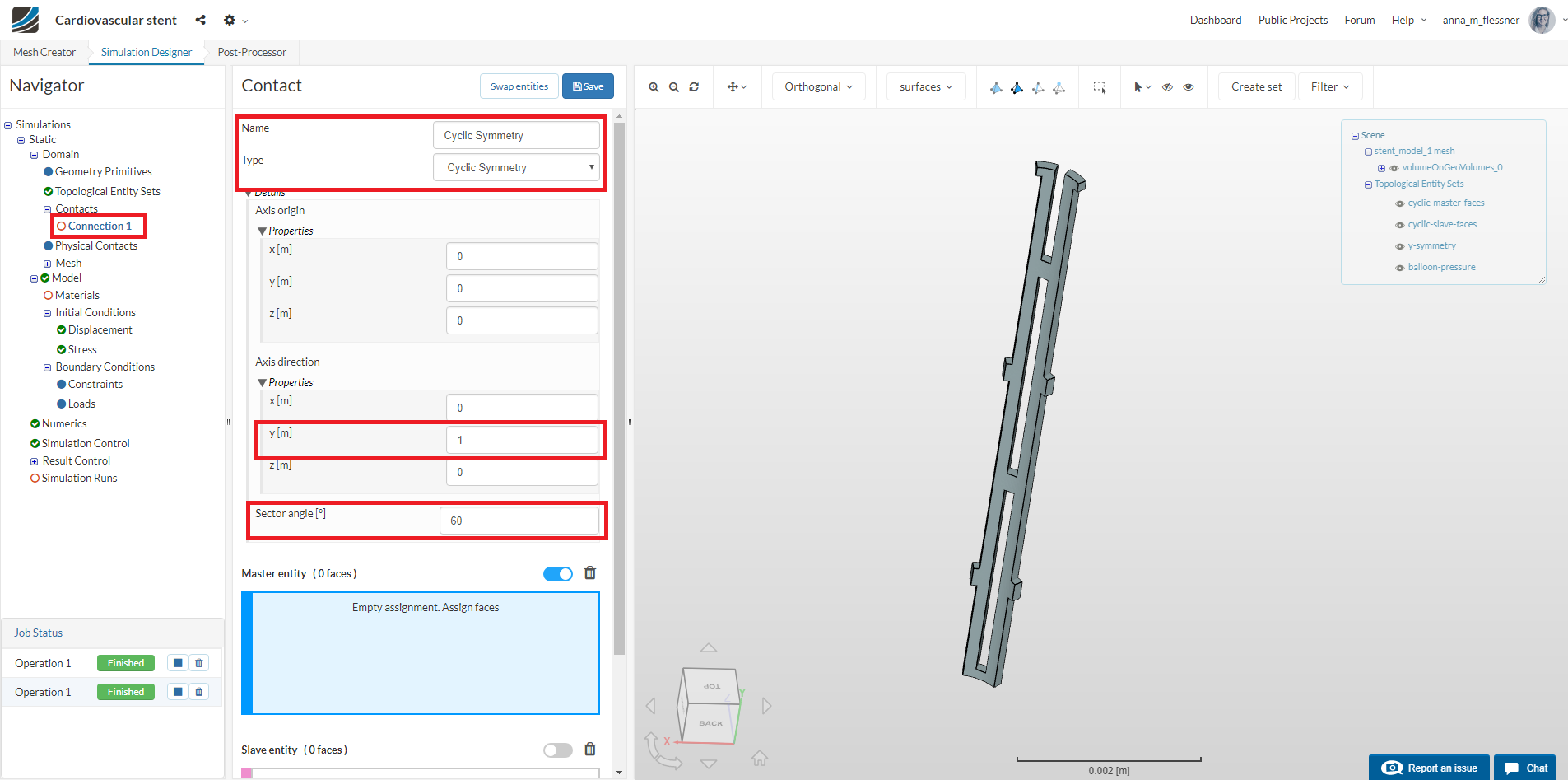

Go to Contacts in the Navigator and click +New to create a new contact definition.
Rename the newly created contact to Cyclic symmetry (optional). Change the Type to Cyclic symmetry. The cyclic symmetry is represented by a right hand rule such that slave surfaces are mapped to master surfaces. Therefore, we give the Axis direction of 1 in the y-direction (represented by our right hand thumb).
Next we have to give the angle in degrees which the slave surfaces will be mapped to master surfaces in order to define the cyclic symmetry. This is 60 in our case since our model curvature angle is 60 degrees (this mapping is according to our right hand curving fingers under the right hand rule).

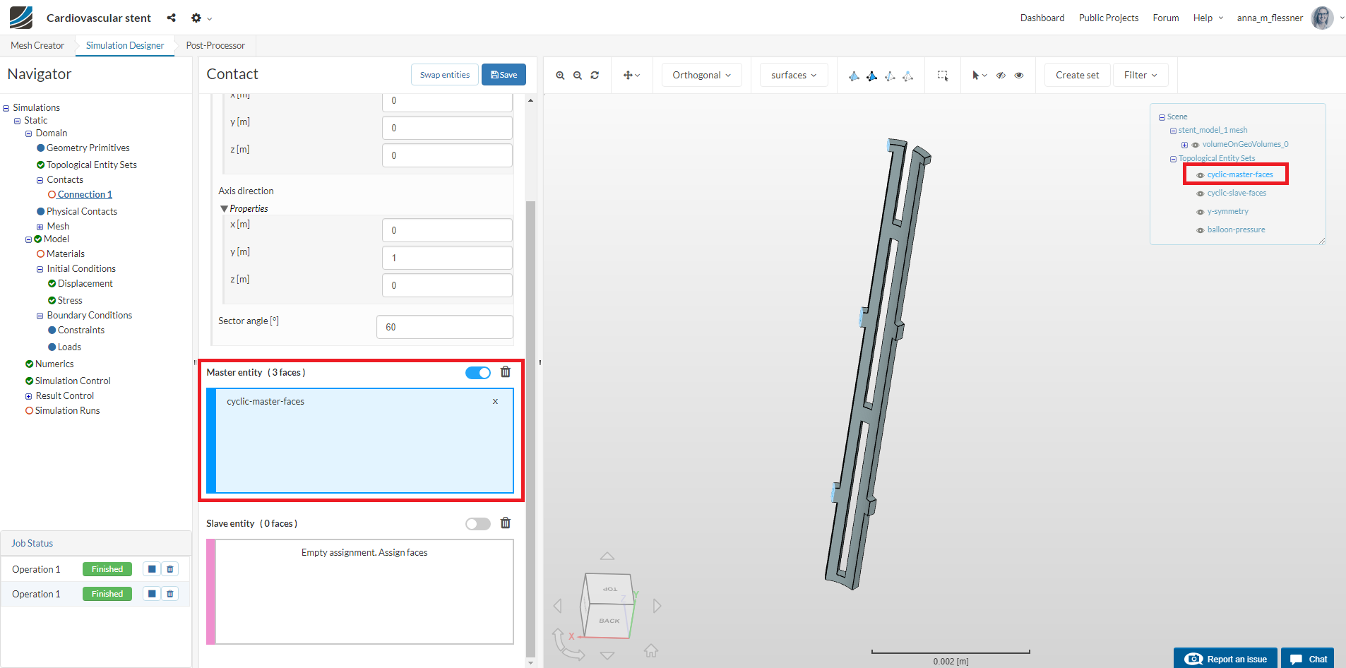

In the master entity box select cyclic-master-facesfrom the scene viewer on the right
Then click on the slave entity box to highlight it in pink. Select cyclic-slave-faces from the scene viewer on the right.
Click Save to define the cyclic symmetry.

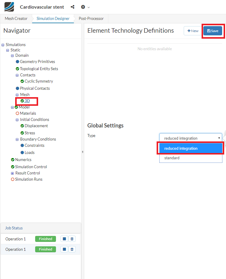

When dealing with a plastic material using second order elements, it’s always recommended to use reduced integration element technology to get more realistic results.
In order to do so, go to the 3D item in the Navigator under Mesh. Change the Type from standard to reduced integration.
Click Save to register the changes.

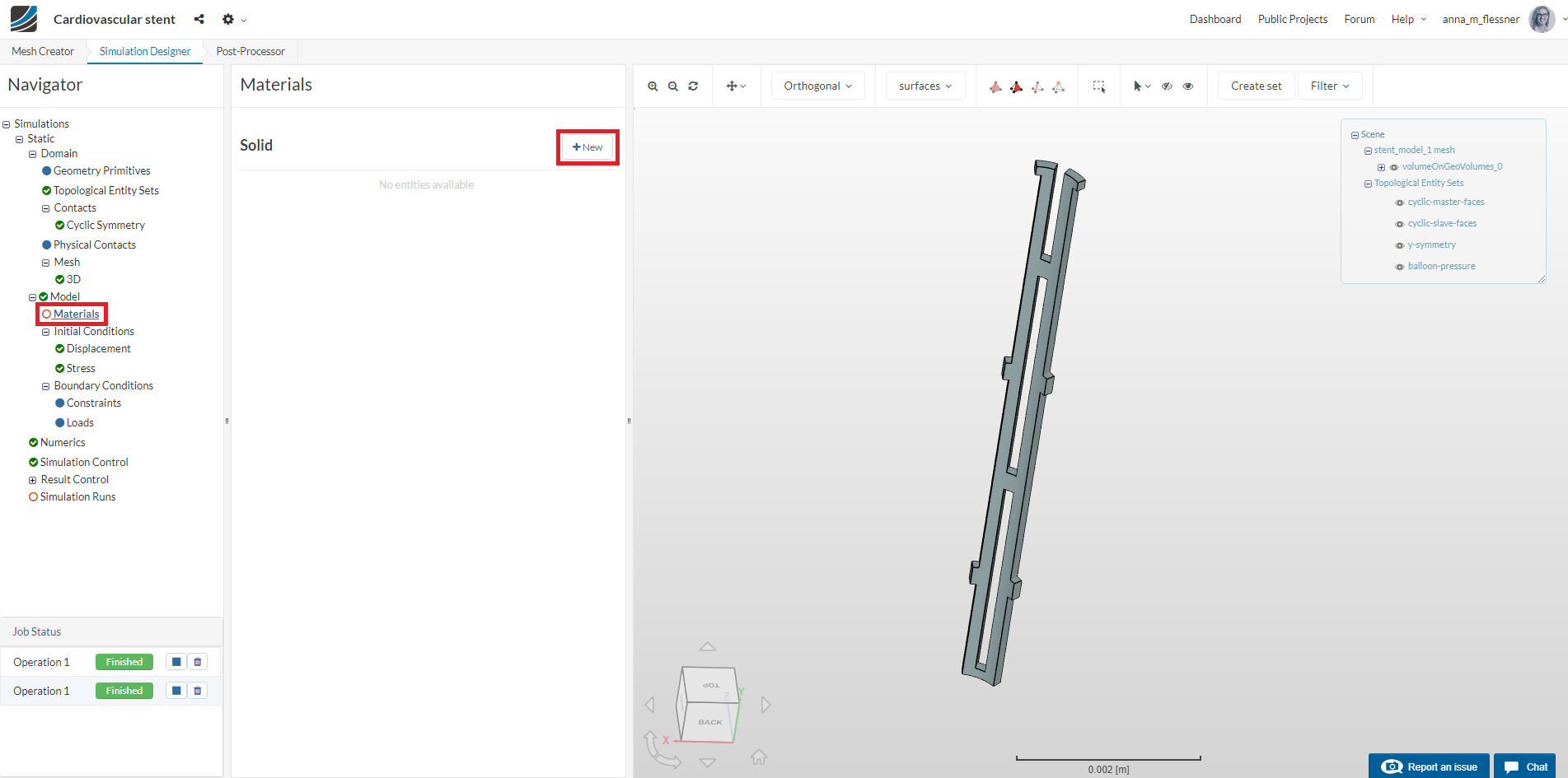

Materials

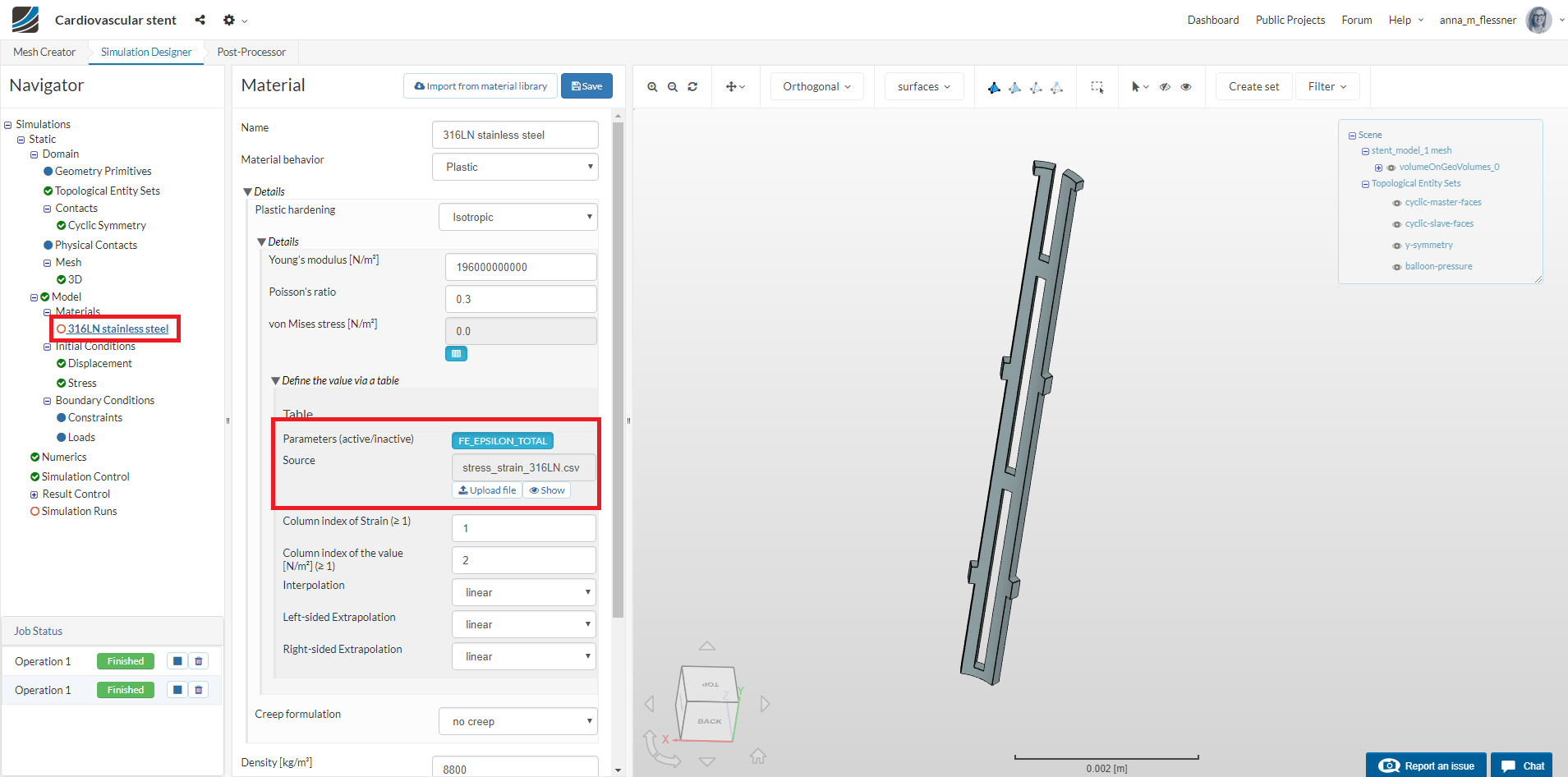

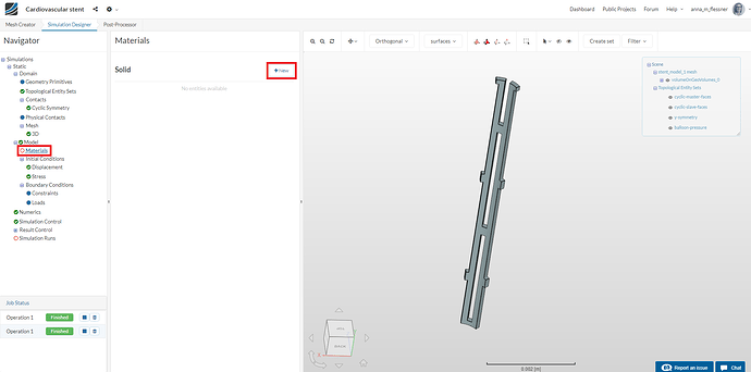

Now we will define the material definition for the stent. The material behavior is plastic since in reality the plasticity of the material is what allows the stent to remain in an expanded shape.

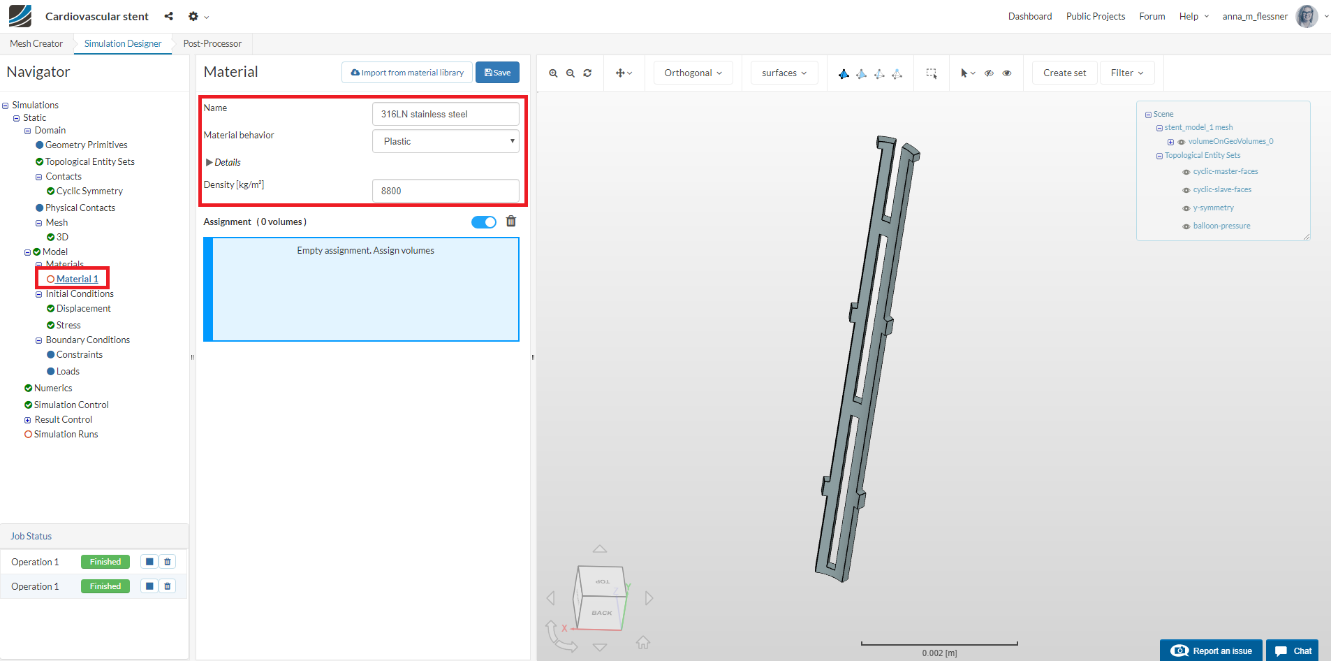

Go to the Materials item in the Navigator and click New to create a new material definition.
Rename the newly created material to 316LN stainless steel (optional). Change the Material behavior to Plastic.
Next, change the Young’s modulus, Poisson’s ratio and Density values to 196e9, 0.3 and 8800 as shown in the figure below.
Now we will create a .csv file with our plastic material data.
The stress strain data in this .csv file will start from yield point of 316LN steel. Just copy the values given below into Notepad (if you don’t have Notepad, you can download it for free here).
In Notepad, save the file as a .csv file e.g. stress_strain_316LN.csv (material data is taken from [1])

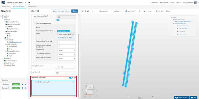

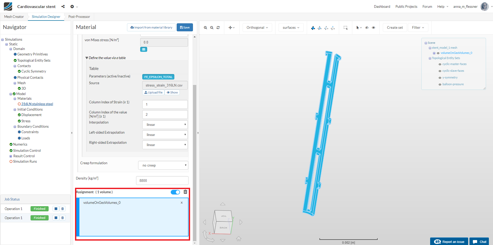

After creating the file upload it to SimScale by clicking Upload file in the Material Parameters.
A pop-up window will open, click Choose file and open your created file from your computer and then click Upload file as shown in the figure below.
Finally, select the volume under Topological Mapping and click Save to define the material for this stent.
You can click Show to see the material data which should look something like this:

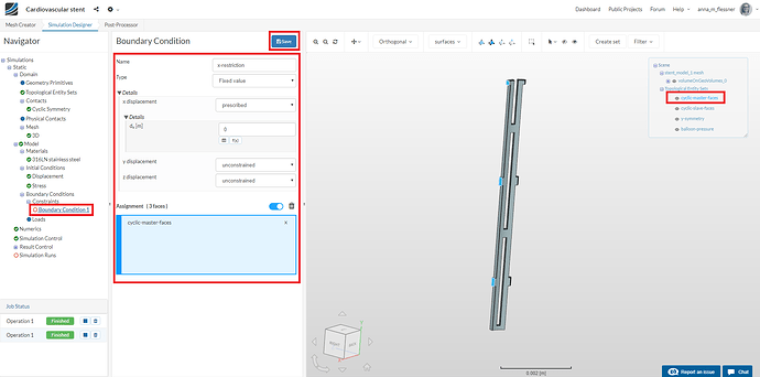

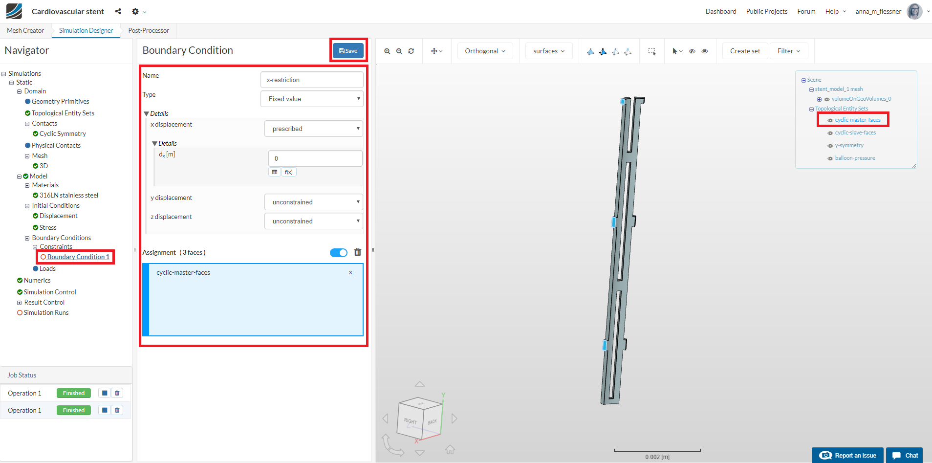

Go to the Boundary Conditions item in the Navigator and click +New next to Constraint to define the symmetry boundary conditions.
x-restriction:
We now have to define the restriction of the x-axis so that the geometry cannot move in the x-direction. Rename the newly created boundary condition to x-restriction (optional) and the Type to Fixed Value.
Set y displacement and z displacement to unconstrained.
Under Assignment select cyclic-master-faces from the Topological Entity Sets in the right scene viewer.
Click Select assignment to highlight the selected assignment in viewer. Click Save to save the constraint.

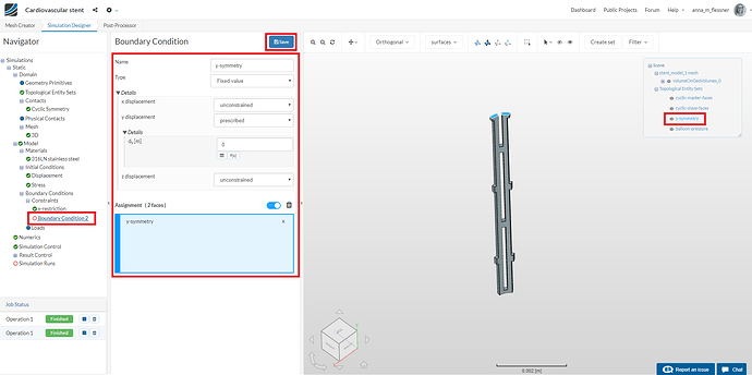

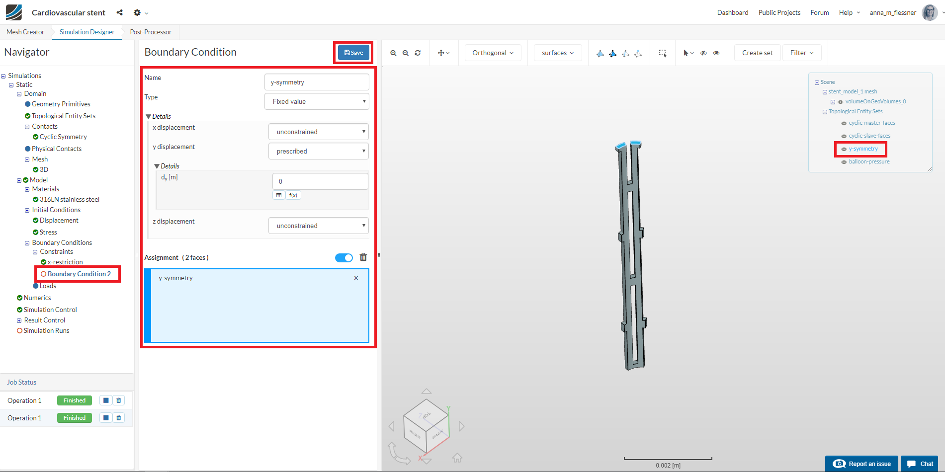

y-symmetry:
We now have to define the symmetry along the xz-plane so that the geometry shouldn’t be allowed to move along the y-axis thus maintaining the symmetry along the xz-plane. Do the same process as before and rename the newly created boundary condition to y-symmetry (optional). This time set x displacement and z displacement to unconstrained.
Under Assignment select y-symmetry from the Topological Entity Sets in the right scene viewer. Click Save to save the constraint.

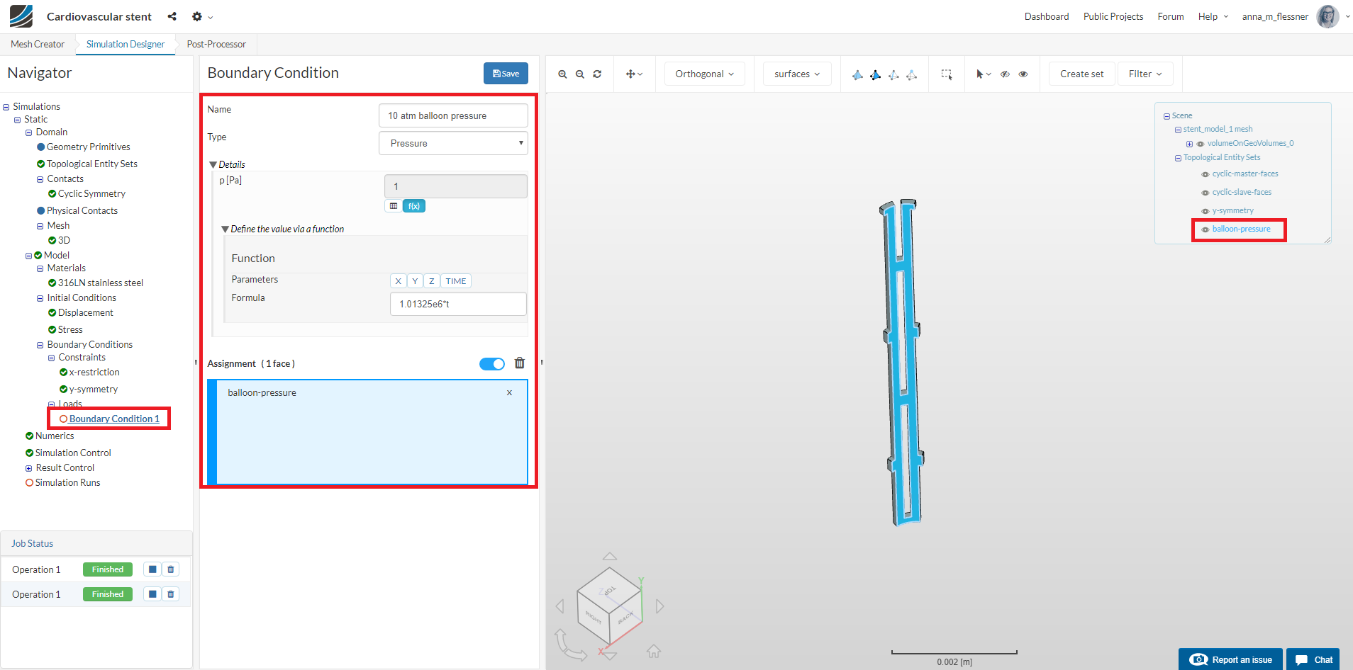

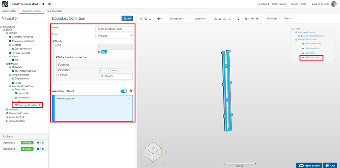

Next we will define our load boundary condition of the balloon pressure on the internal surface of the stent. Proceed to the Loads item in the Navigator and click +New to create a new load definition.
Rename the newly created constraint to 10 atm balloon pressure (optional). Set the Type to Pressure. Click the f(x) button below the pressure value and input 1.01325e6*t, this will ramp the load over time since this is a nonlinear case
Go under Topological Mapping and select balloon-pressure. Click Save to save the constraint.

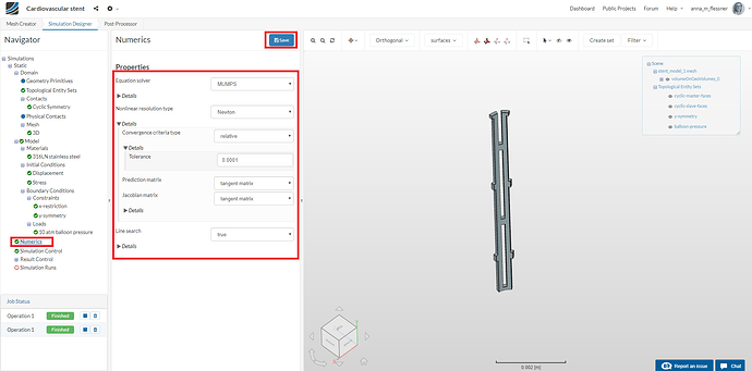

Numerics

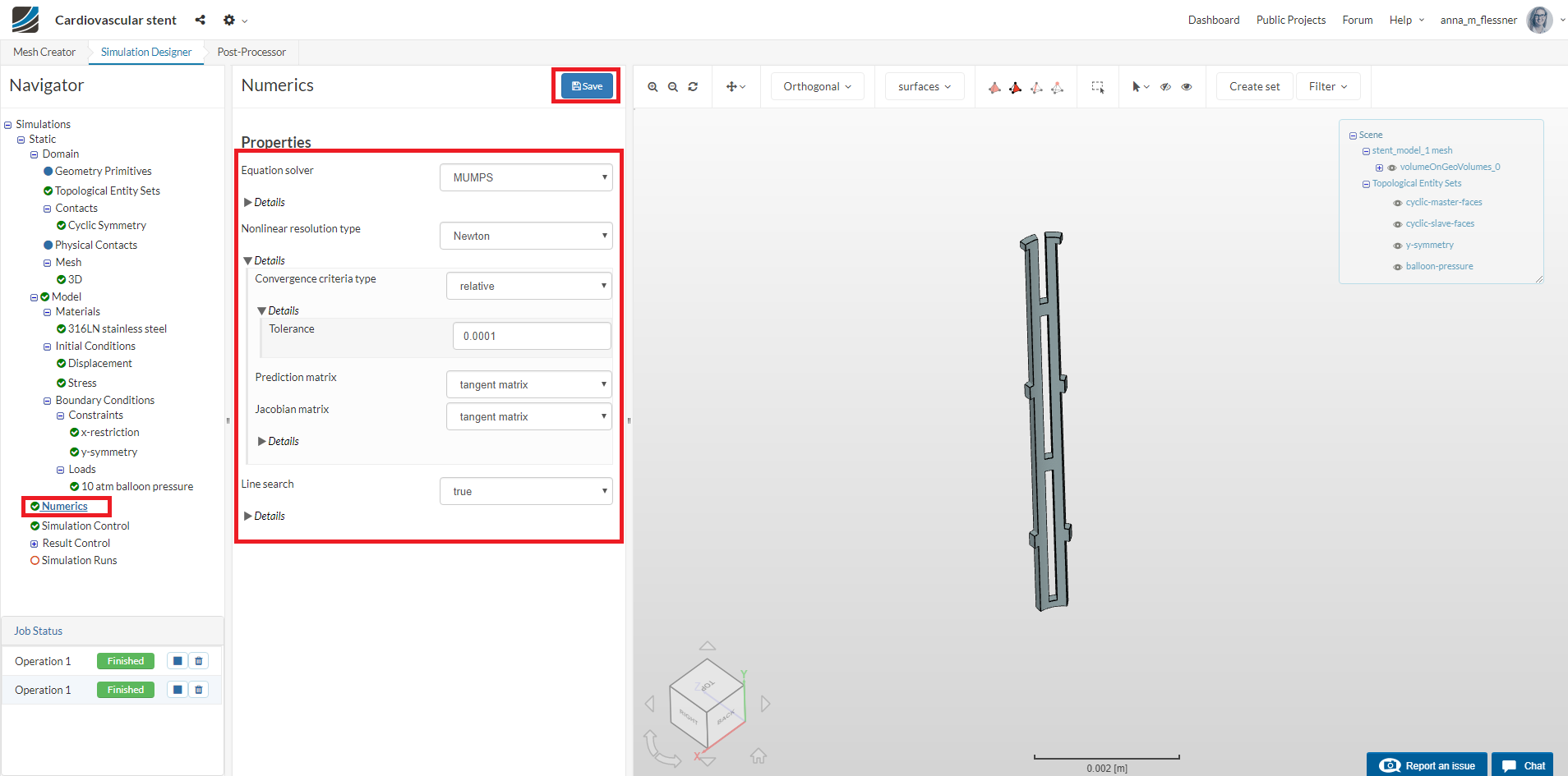

Go to the Numerics item in the Navigator and change the Equation Solver to MUMPS which is a faster solver for large nonlinear problems. Next change the Tolerance of relative error to 0.0001 under Convergence criteria.
Turn Line search to true which allows better convergence in case of material nonlinearity.
Click Save to register your changes

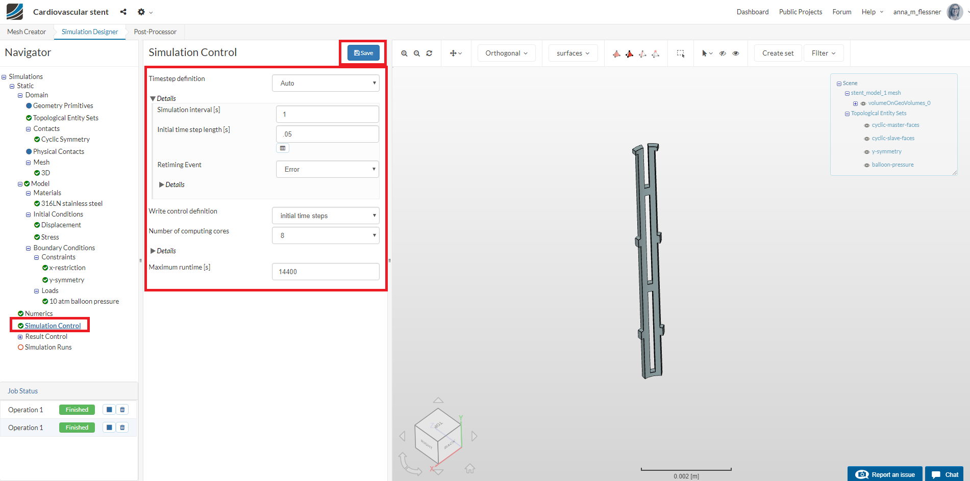

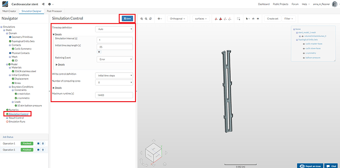

Simulation Control
Click on Simulation control and change the Initial time step length [s] to 0.05, Number of computing cores to 8 and Maximum runtime [s] to 14400.

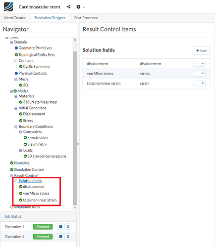

Result Control

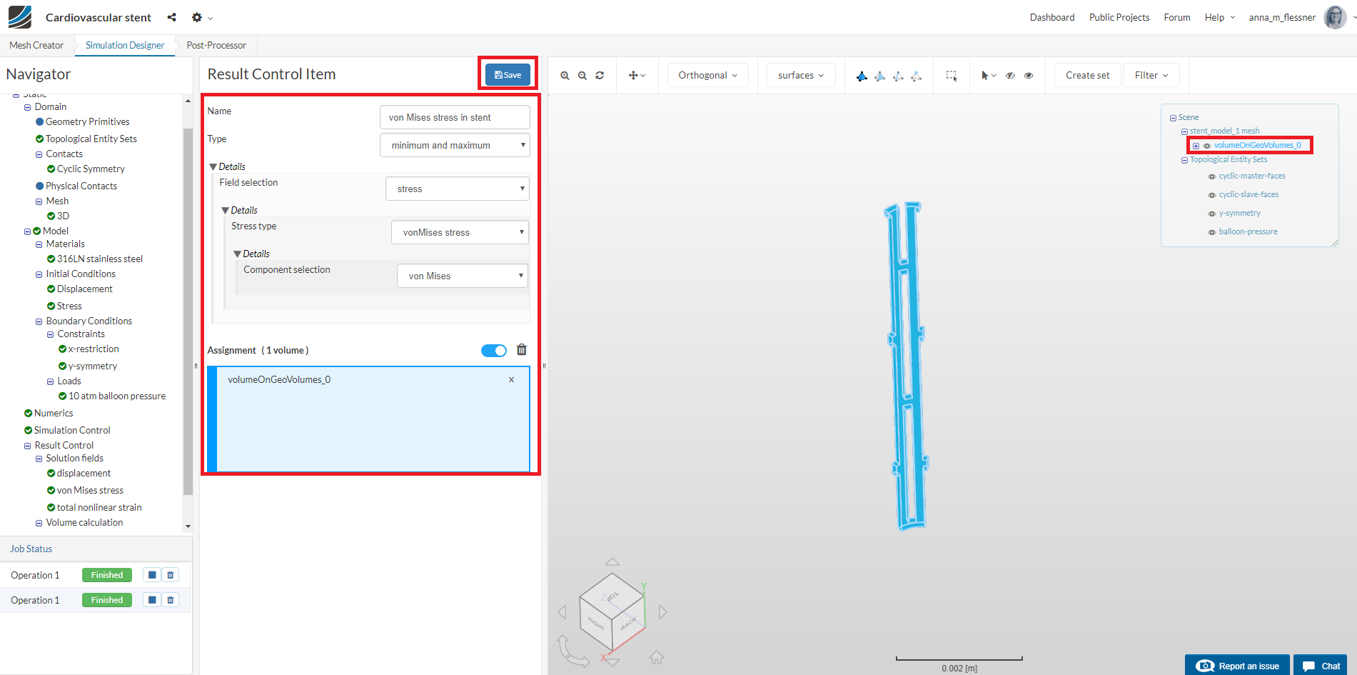

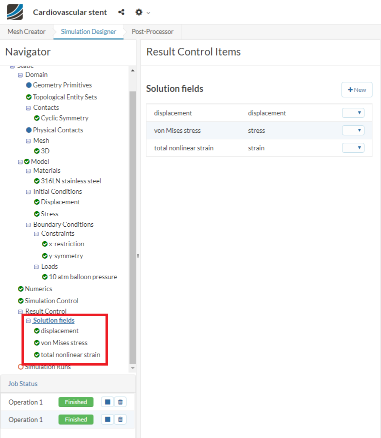

Next we will delete the cauchy stress solution field in order to save time and memory. Do this by right clicking on it and then selecting delete. The Solution fields will then look like as shown in figure below.
Click on Result Control and then +New next to Volume calculation to create a new volume calculation definition.
This will create a new volume calculation definition which will help us to plot the maximum and minimum von Mises stress in the stent over time. Rename it to von Mises stress in stent (optional), change Field selection to stress, Stress type to vonMises stress and then select volume from the Topological Mapping.
Click Save to define the volume calculation method.

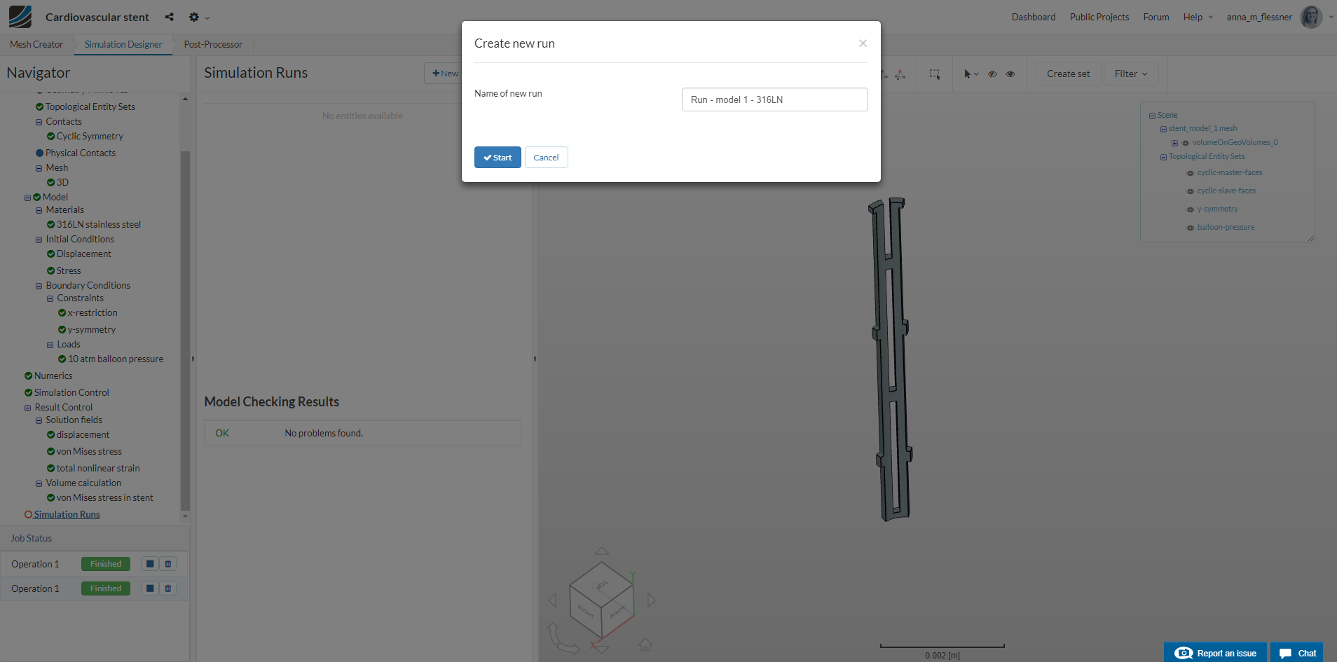

Now we are ready to create our first simulation run. Click on Simulation runs and create a New run. Give simulation run a suitable name in the pop-up window that appears e.g. Run - model 1 - 316LN (optional) in this case.
Click Start to run the simulation.
The simulation run will take approx. 35 minutes to finish. Now you can proceed to configurations 2 , configuration 3, and configuration 4

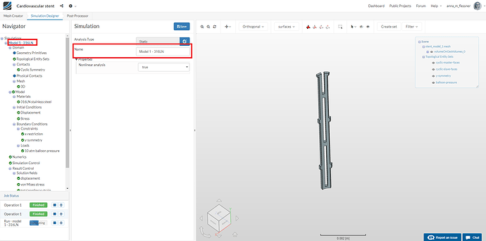

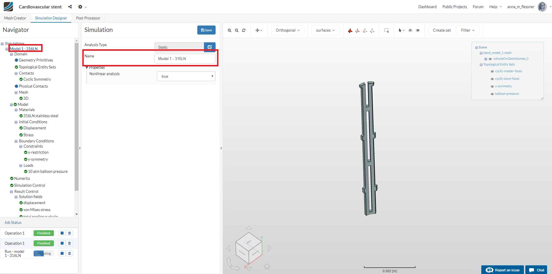

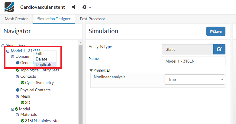

Once you have started the run with the first configuration setup, rename the simulation to Model 1 - 316LN
Then make a duplicate of this simulation in order to perform the simulation with different material type.
Rename the simulation to Model_1 - L605 Co-Cr and click Save

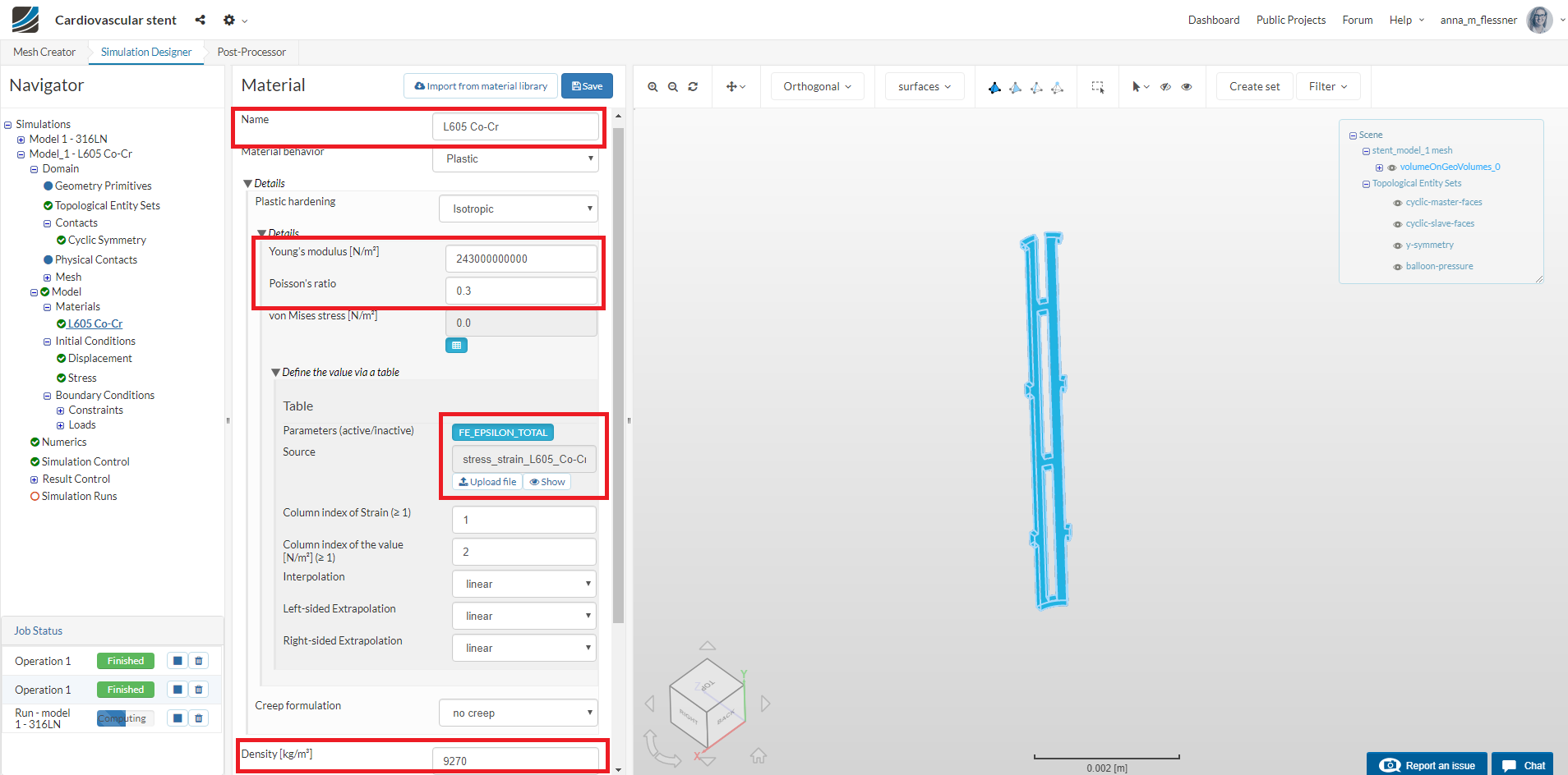

You need to first change the material definition of stent to L605 Co-Cr. Click on 316LN stainless steel under Materials, rename it to L605 Co-Cr (optional). Change the Young’s modulus, Poisson’s ratio and Density values to 243e9, 0.3, and 9270 as shown in figure below.
Now create the new .csv file by following the same steps as before with the stress strain data given below (material data is taken from [2]):

Click Save to save the new material definition.

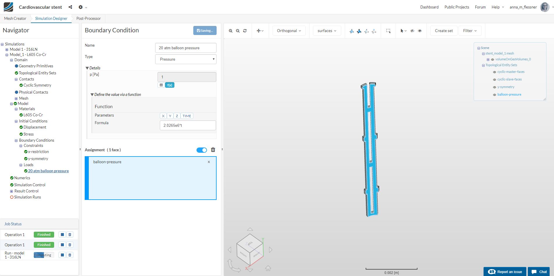

Next change the 10 atm balloon pressure to 2.0265e6*t and rename it to 20 atm balloon pressure (optional).
Click Save to register changes.

Finally create a new run and rename it to Run - model 2 - L605 Co-Cr (optional) and click Start.

I keep on running into an issue when trying to set my material properties for the stent. After creating a new material property, the only material behavior I can select is “linear elastic.” How do I add “Plastic” to the material behavior?
Hi @gustav0naya!
Please set “Nonlinear Analysis” to true. It should work then :slight_smile:
All the best and have fun with the workshop!
Had an issue saving the material properties as a .csv file because I couldn’t download the notepad, uploading into excel seemed to do the trick in case anyone else has the same problem!
So just copy all values into Windows Text, and delete all “<”, and then save as .csv, It should be fine

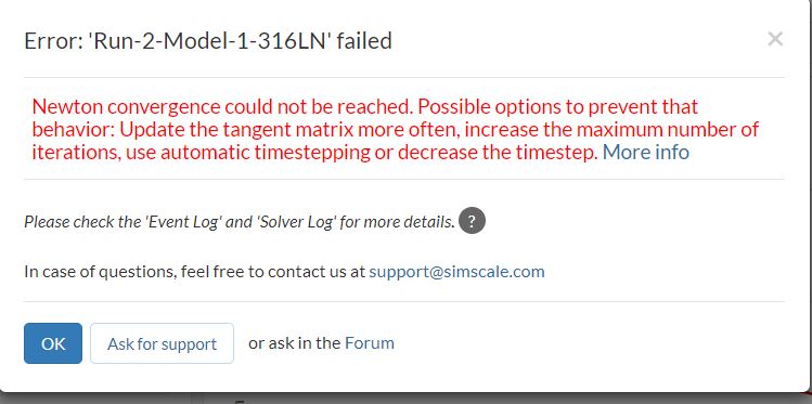

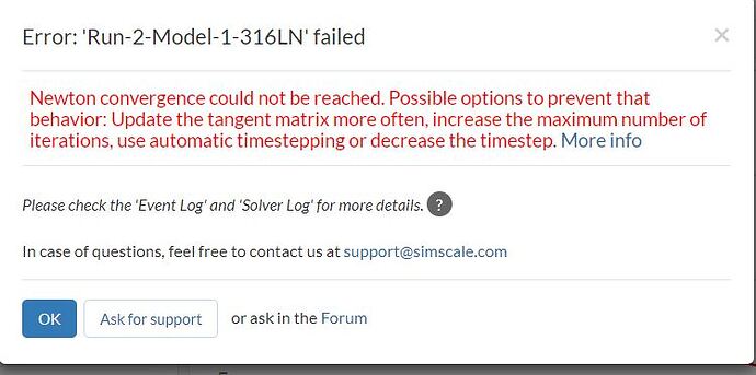

Error, for Configuration 3, Newton convergence could not be reached, does anyone has a idea what happend?
Hi @cican17!
As far as I can see you already deleted that job. For some error messages you have the possibility to click on More Info to see what you can do to prevent those errors.
Let me know how things go!
Hi, Josef, thanks for your reply, I just fixed this problem, since I forget to set the 3D Mesh as reduced integration. Thank you !
