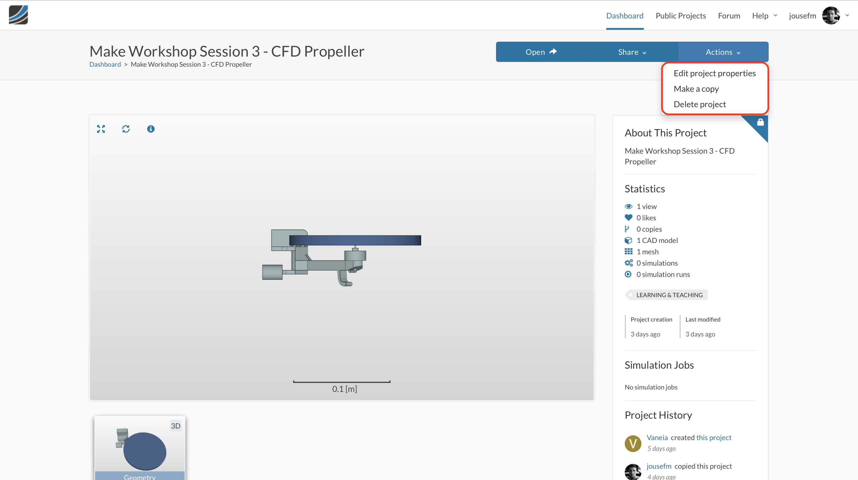

as depicted in the picture below you go to the menu at the top right corner, click on Edit project properties and on the new page that is opening you can change the project visibility at the bottom of the page.

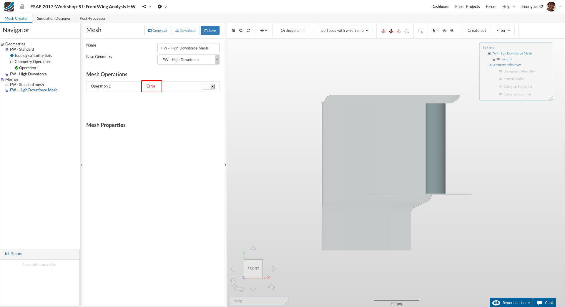

I’m getting this error when trying to run the high downforce mesh operation. this may be what is causing another problem, where when i try to create a simulation, i cant select the either of the geometries, i get this message:

this is the link to my project. the error is occuring when i run the downforce mesh operation to produce the mesh
Hey @pgatto!
So, I took a look at the project you shared and I have found the issues.

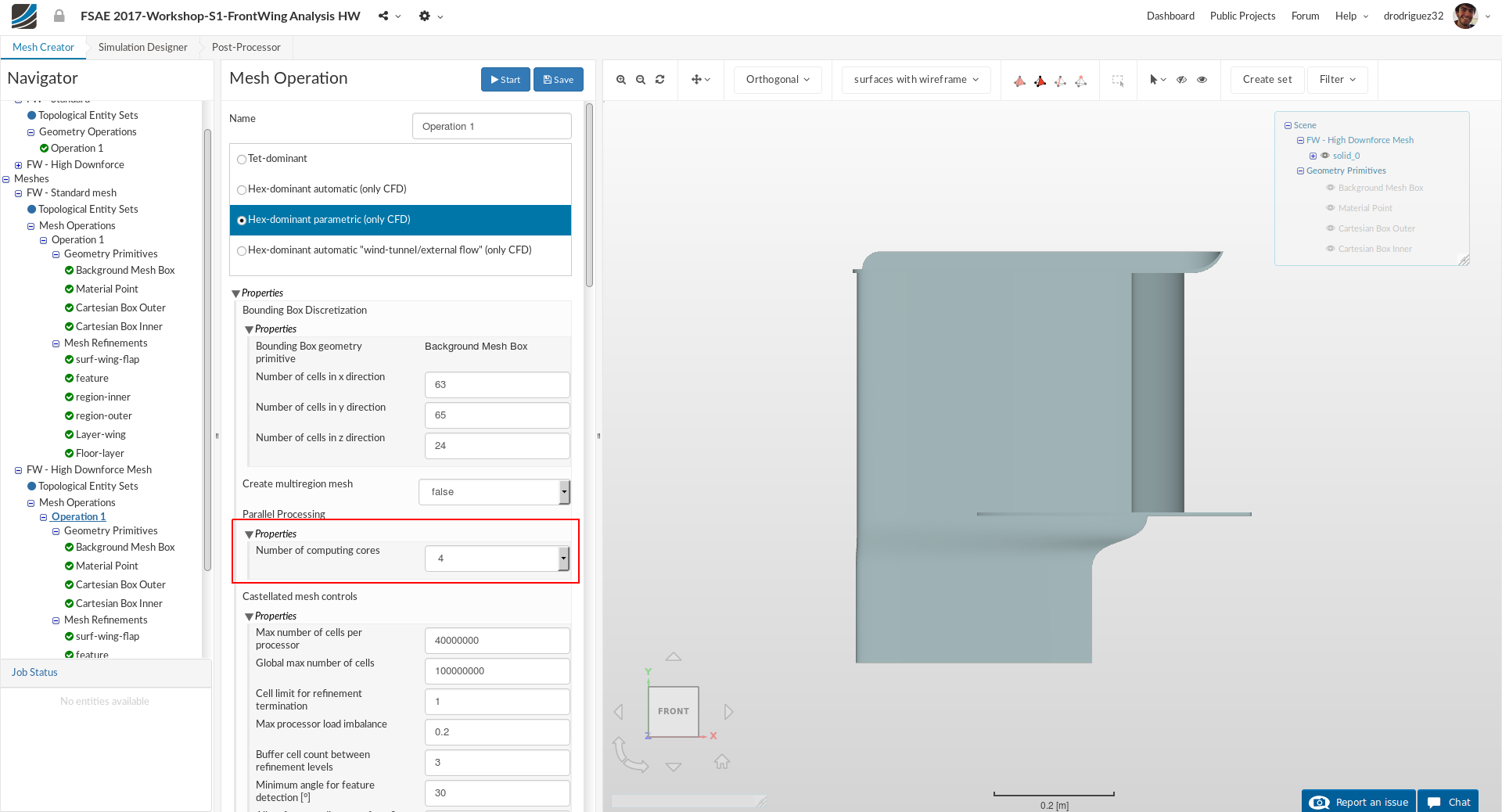

  1. It seems you didn’t change the number of computing cores from 4 to 16. It’s really important that you assign 16 cores so that you get a big enough machine to run the mesh. This is why you’re getting the “machine ran out of memory” error. I would recommend that you go over the mesh setup just to be sure all the details are fine and remember to click on save every time you make a change.

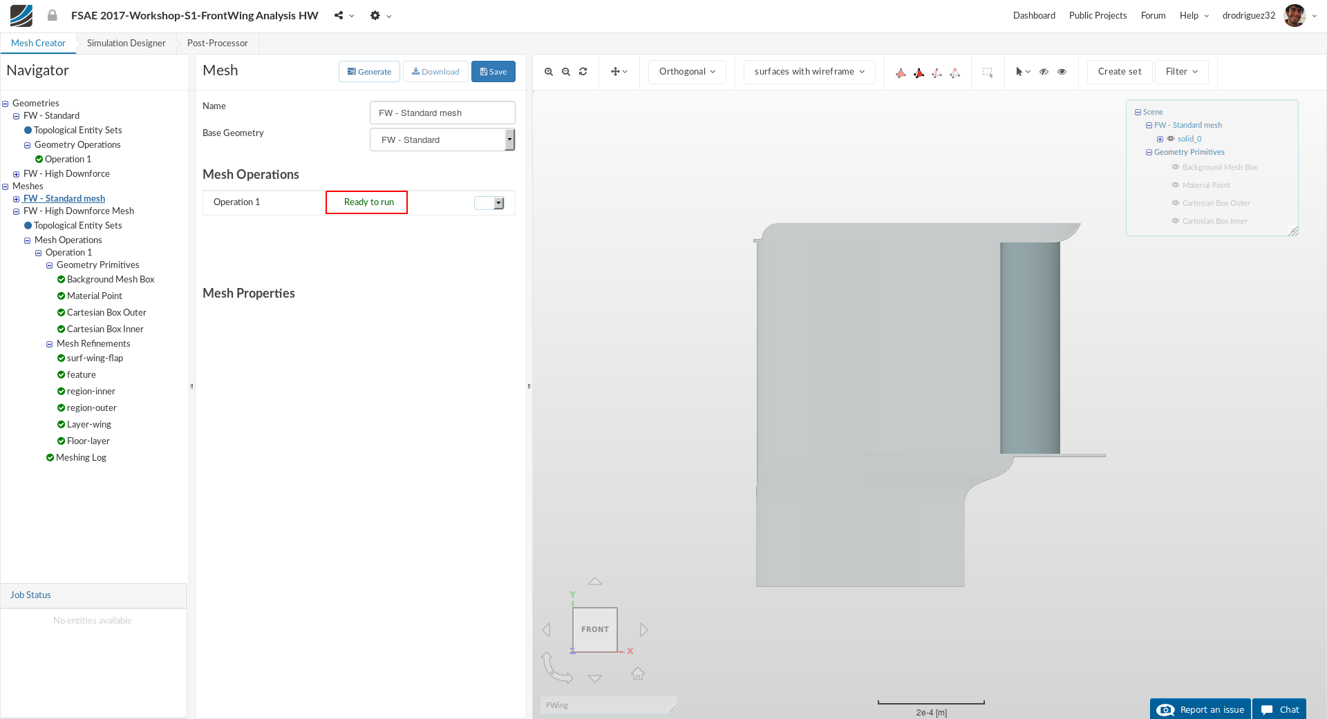

  2. The second issue is happening due to the fact that you never got a mesh. I looked at your mesh setup for the Standard model and the High Downforce model and here’s what I found:
    a.
    b.
    Your mesh operations never ran, so it’s impossible to create a simulation. When you go over all your mesh setup please remember to go back to Operation 1 and click on Start to actually run the meshing. When that is done, inside of the red boxes in the images above you should see a green label that says Finished.

Thank you so much! the 4 cores is definitely what was impeding on the rest. Thanks again @jousefm!
