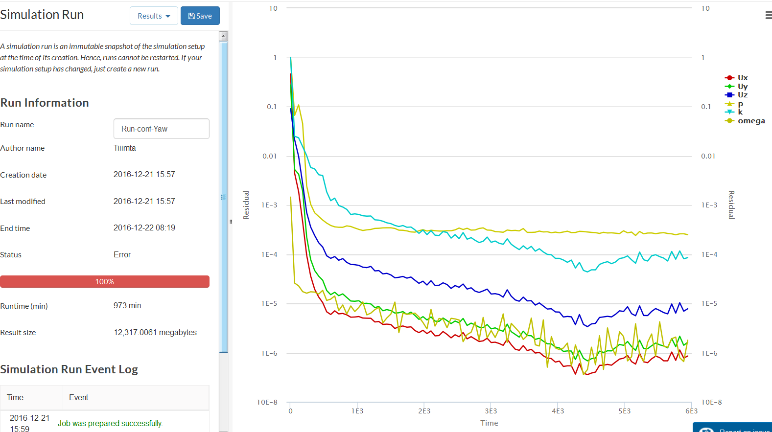

I had the Simulation done this morning, but after a runtime of 900+ hours an error occured.
End Tim value was 6000
Maximum run time was 600000
cores: 32
Any idea what i should do?
Thanks in advance
