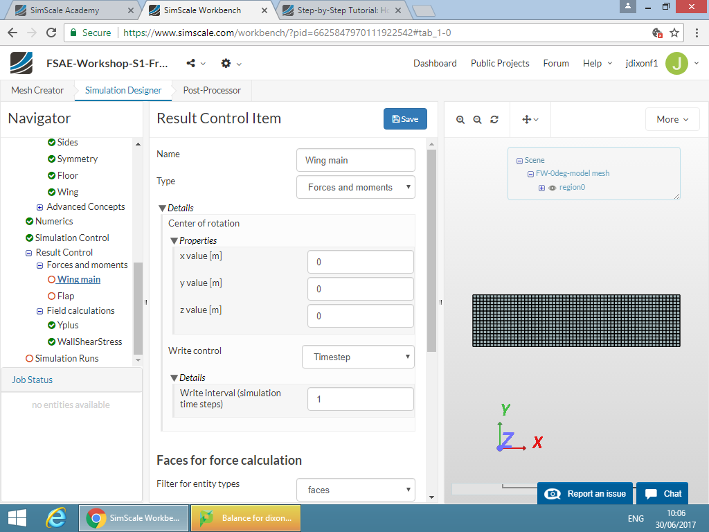

Hello, I have just come across this course and have gotten a majority of the way through the first exercise. However, on 3.14 Result Control where it says to change Density value [kg/m^3] for the Wing main and Flap Force and Moment Result Control Items I don’t have that option, instead it just says Center of rotation with no changeable values, why is this?
Hi @jdixonf1,
in the meantime the user-interface has been updated and the density is now directly taken from the material definition.

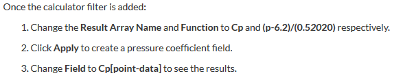

I got a question regarding the calculation of cp.
Why did we subtract 6.2 of the pressure to calculate cp?
How did you calculate 6.2?
Thank you in advance.
