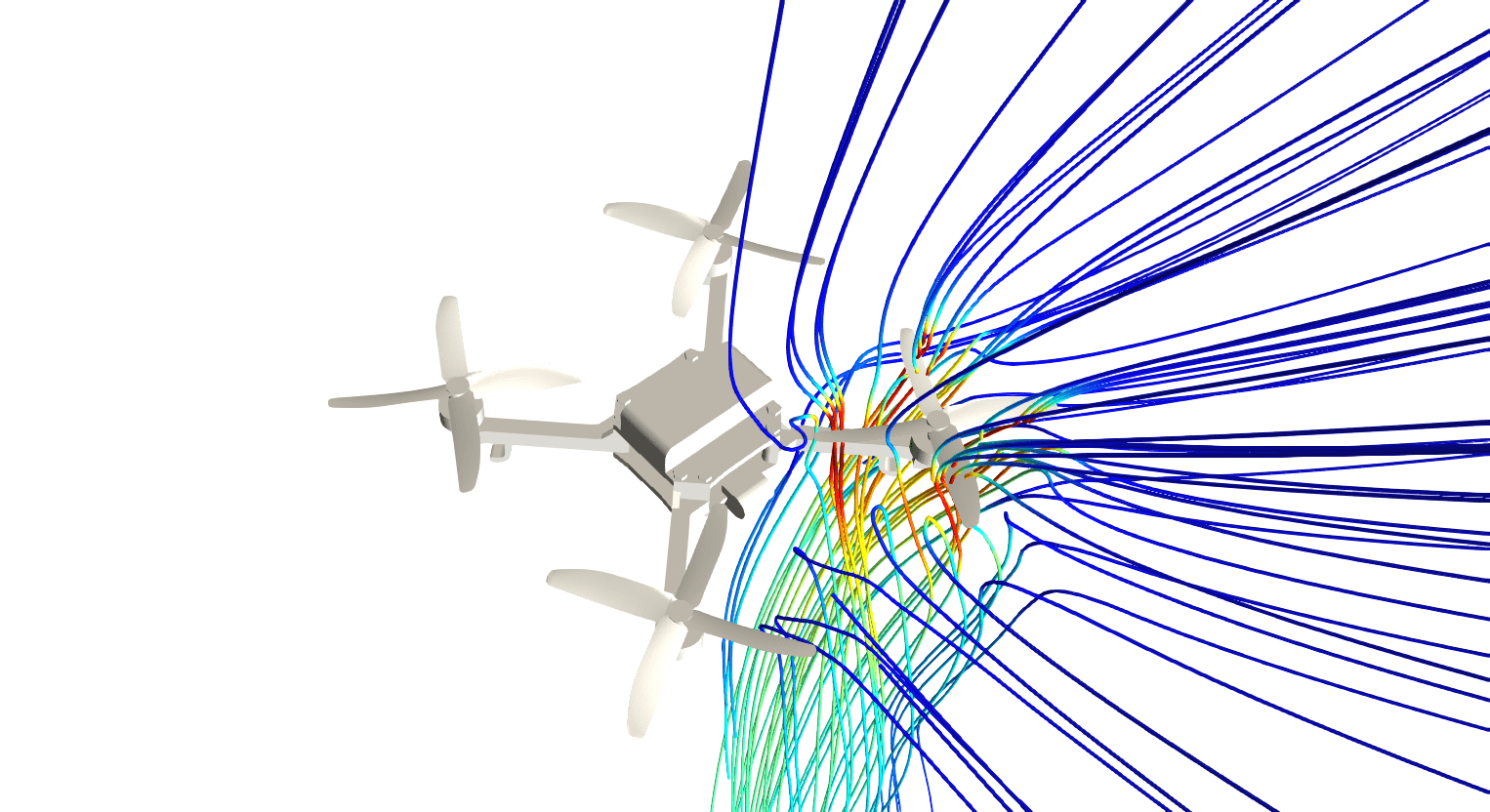

Furthermore you’re having another issues regarding volumeRatio, skewness, etc. Hence we did this incompressible simulation using symmetry strategy, increasing the mesh quality and decreasing the computational cost. Please take a look at the tutorial down below, also feel free to make a copy and improve on your own ![]()
