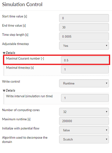

Point 2 - Courant number - can you give me more dtails i didn’t find it.
thank you
Hi @mcusmariu!
Please see here: CFL condition
You will find it on the platform under Simulation Control

Hello Ahmed,
I increased to 0.9 and I’ll start a new simulation.
I’ll keep you informed if there is an improuvement.
thank you
Mario
Hello again,
We have an improvement 106 min. vs. 173 min but steel very very long for a 7 seconds simulation.
