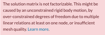

My simulation keeps failing I tried making changes but it keeps failing; what should I do?
If anyone knows the settings I should do that would be much appreciated.
Hi @kilgore_802,

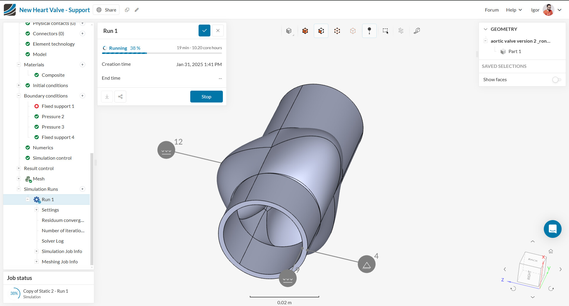

Your problem is most-likely over-constrained. I’ve removed “Fixed support 1” and your simulation seems to be running normally (at least w/o the Matrix factorization issue):
Project link.

Hi @kilgore_802,
I’m not sure concerning the fittingness of your simulation in general - however the issue you’ve shared in this topic has to do with your setup (i.e., it would fail with both linear and non-linear material definitions).
