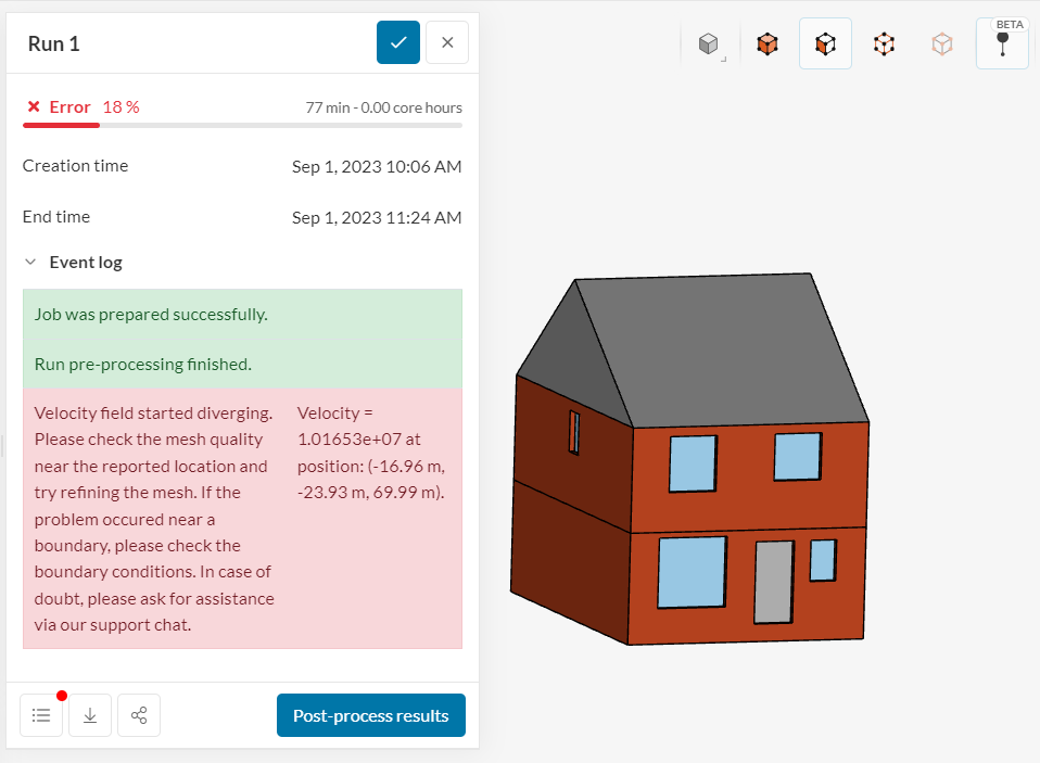

I’m trying to do a “Conjugate Heat Transfer v2.0” simulation. The purpose of my simulation is to simulate two people dancing in a house and see where goes heated air they will produce.
I have already assigned a boundary condition on them. However, when I try to run the simulation, I got some issues. This message displays “Some non-intersecting CAD bodies have not been assigned a material. Please check that you have assigned a material to all non-intersecting CAD bodies.”
I think it’s because the shape that I assigned the boundary condition to simulate two people, doesn’t have material. My problem is that I don’t know if I need to create a new material for them or if it’s better to delete them and assigned the boundary condition to the gap they will create in the airflow ?
Somebody can help me please ?
