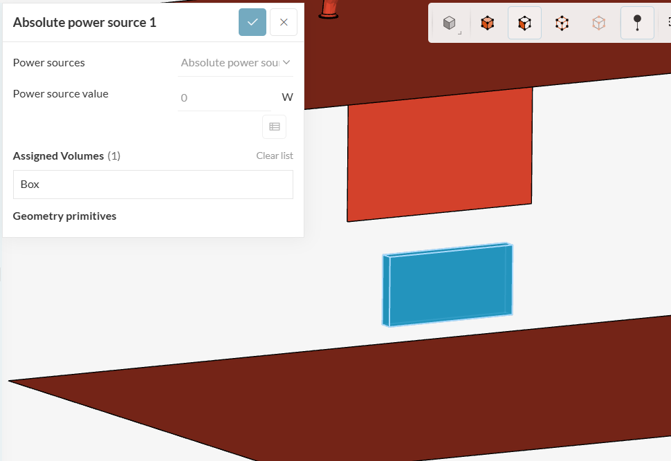

Other than that, you are using a CHT simulation with a single power source with 0 W (image below). Maybe try running a simple incompressible simulation instead without the power source geometry in the model at all.

I need to use CHT simulation because I want one variant with the heating on and the other without the heating on. And I tried everything in the link, but I still can’t fix it.
