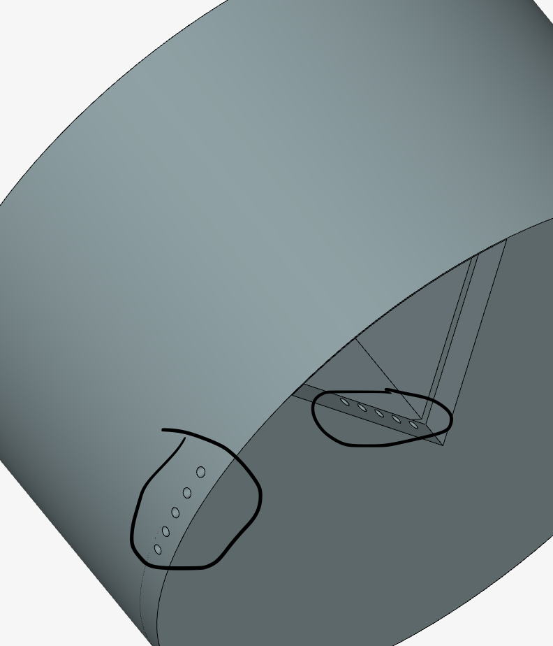

I’m trying to run a simulation of a reactor containing a hot air plus a viscous liquid flow.
The hot air flows through the little holes near the output of the liquid:

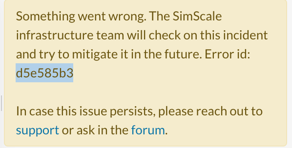

I already tried this tutorial How to Prepare the CAD for Simulating Rotating Zones | SimScale on how to achieve said rotation and created a rotation zone on my CAD (I use NX) but cannot get past the CAD part of simscale itself. Has anyone encountered similar problems or already knows how I can work past that? When I try to do what the tutorials says I receive the following error notification:

The fluid volume. When I try to assign an internal flow the above mentioned error notification d5e585b3 pops up.
In the posted screenshots the rotating body is hidden.
Ok. I understand now, that I have to delete the solid that is rotating. Like this I managed to implement the internal flow. But I don’t see how that is what I want. The solid that will be rotating, is the thing generating the flow. Without it I don’t see how the simulation can run physically accurate.

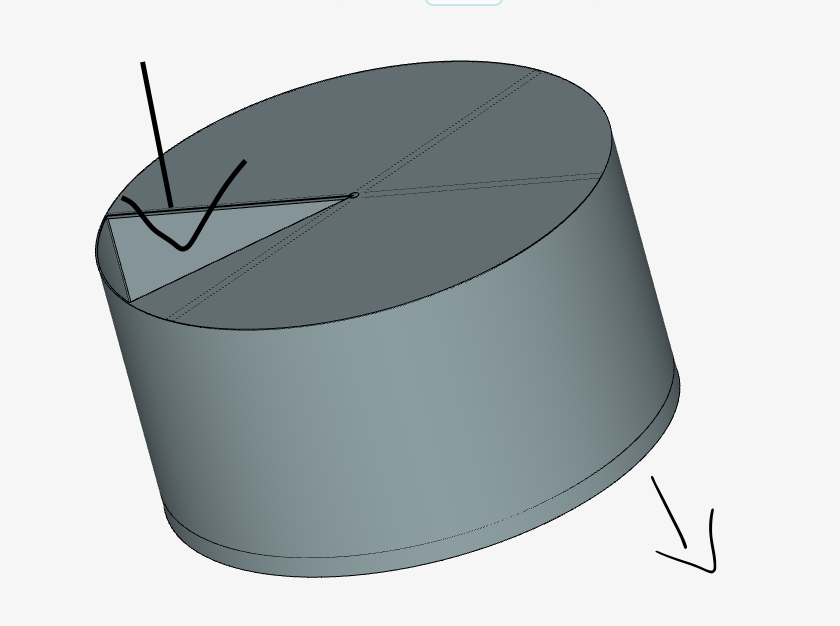

Let me try to explain again what I am trying to simulate: it will be a reactor containing two mass flows. One hot air flow through the small holes you can see above and a second mass flow of a viscous fluid, that is heated by first one. The 2nd screenshot shows the in- and output of the second flow. The fluid will be transported by the very slow rotation of the star like structure, which you can see on the last screenshot.
