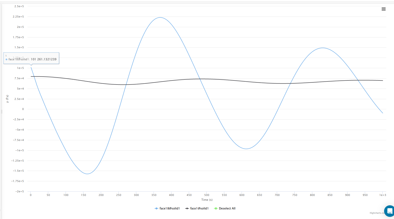

I am comparing simscale with other CFD softwares and i cannot accomplish this simulation. Simple pipe of 8 inches and 30 meters, 17000 kg/h of air at 115ºC (properties looked online). I do not know why but the results end up diverging. Please help

I noted that the flow velocity is a ~160 m/s which is higher than the suggested limit for incompressible flow which is set to mach 0.3.
In addition I noted that you have adjusted the relaxation factors, what was the reasoning behind this?

I am seeing your results for the same simulation I did. In this case the pressure plot follows the same problem. What we can do to solve it?

I have been trying other models that might make this simulation easy and faster to solve. In this case we try a 16 inch pipe of 2 meters, with 29000 kg/h of flow at the outlet and a pressure at the inlet of 79330 Pa.
This make the fluid’s speed way lower than the other models but the pressure at the outlet still show a sinusoidal behaviour
