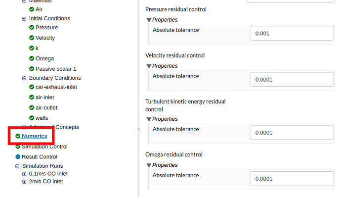

As another hint in the meantime, if you’re dealing with steady-state simulations: The Numerics tree item let’s you set convergence criteria / residual tolerances for all solution fields:
That way you can bump up the number of iterations but set a criterion at which it should terminate the simulation / consider it converged. This approach could help at least in some cases.

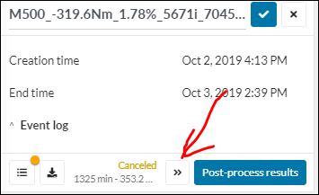

Sometimes you will see a ‘Continue’ icon:
EDIT: The fix has already been made so that the ‘Continue’ icon is always there, see below and thank-you @rszoeke :clap:

It would be really nice if you could show on that image I posted, accumulated minutes and core hours for the 1st run plus all continuation runs INSTEAD of just the last continuation run… :pray:
