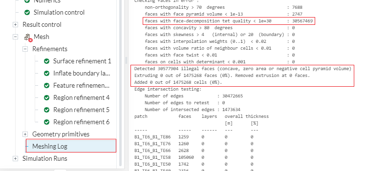

Just not to leave you hanging in respect to y+, this is the (or one of the) causes for your issues with layers: all of them are being deleted, as you can see in the meshing log:

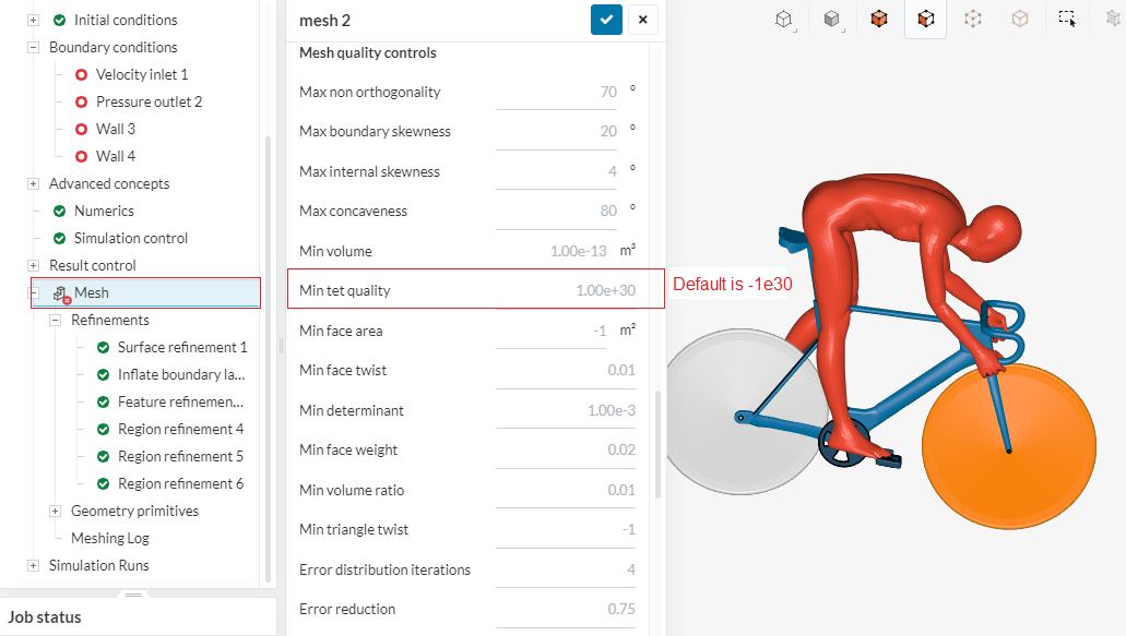

This quality parameter (min tet quality) can be turned OFF by inputting a big negative number (e.g. -1e30, which is the default setting). I believe you must have changed it by mistake to 1e30:
