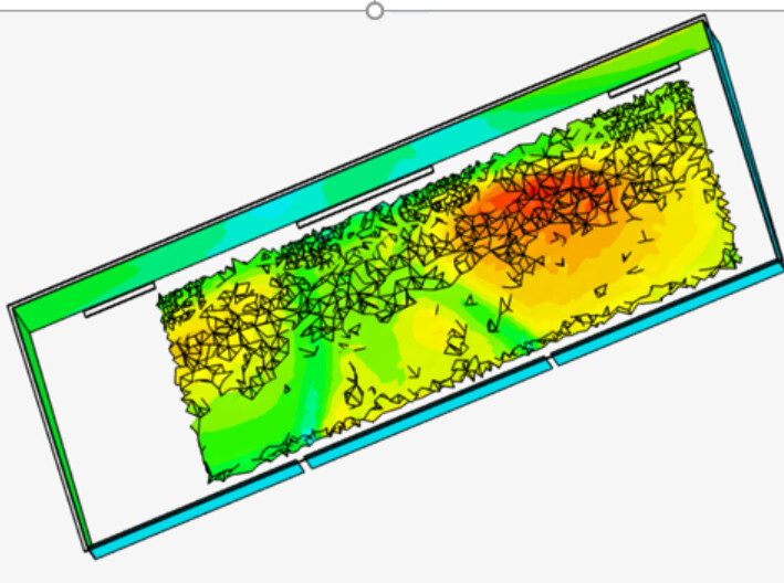

Hi there, I keep getting nodes on my simulations as per image below. Just wondering if this is normal or can i remove them?
Thanks

HI Sebastian, thanks for quick reply - it’s called Rec Centre 10 . I’m looking at simulating natural ventilatiothrough a building. and just wanted to turn off the “nodes” if 'what they’re called?

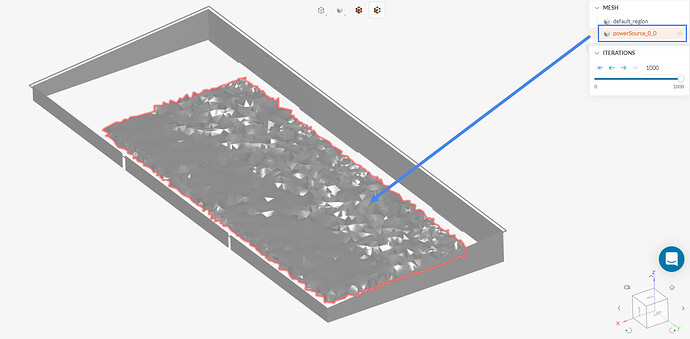

it seems like the boy you are seeing is the power source:
The box is so crinkled due to the low resolution of the mesh inside of the building.

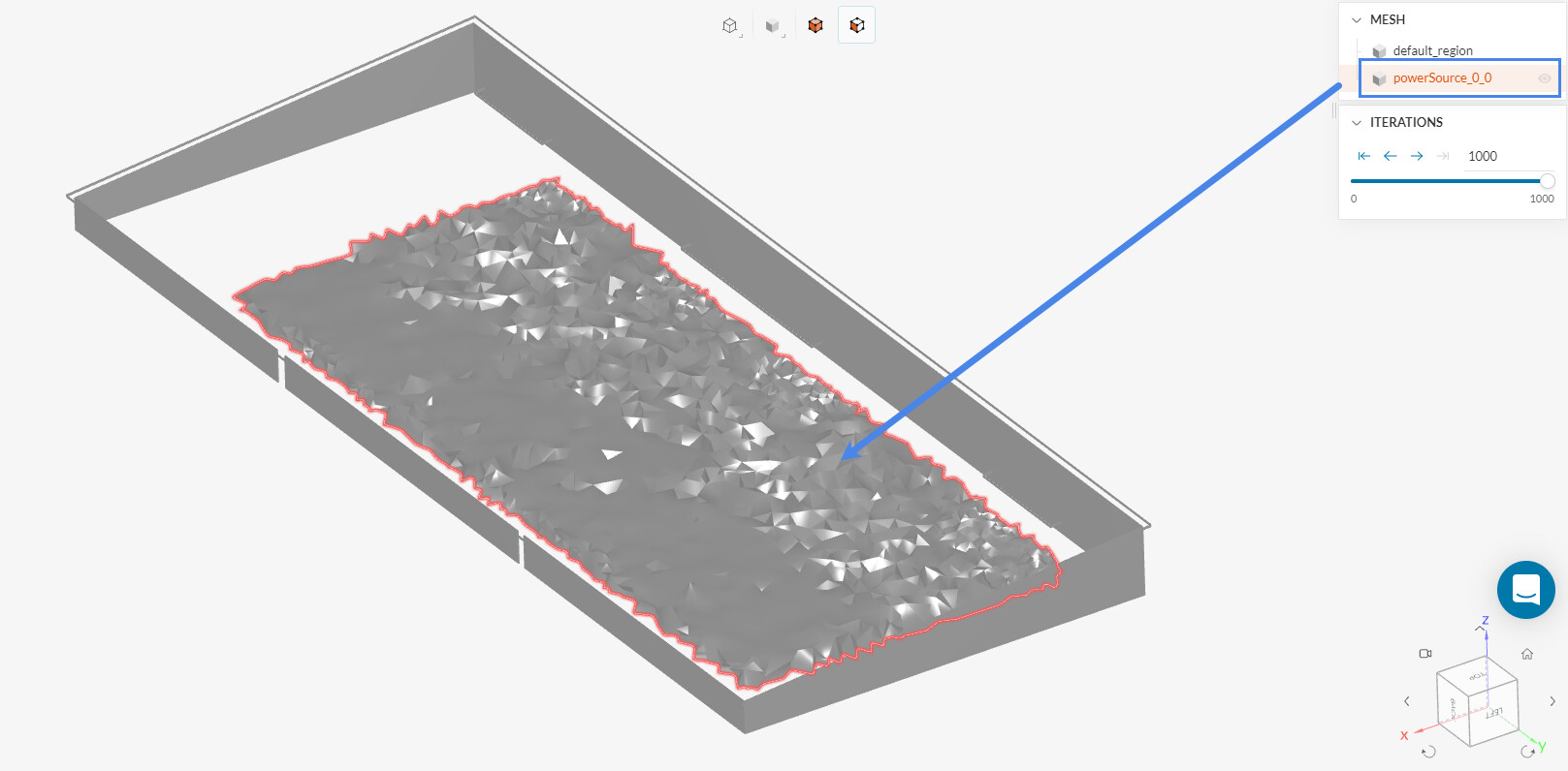

Youz can simply ide it by clicking on the eye icon on the right-hand side.
Alternatively you can change the render mode to surfaces as described here under section :
