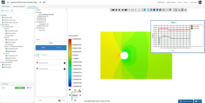

In the new post-processor you can get the Pressure (velocity or whatever) values over the time using the 2D Plot tool:
If that is what you are seeking, please have a look at this SimScale doc.

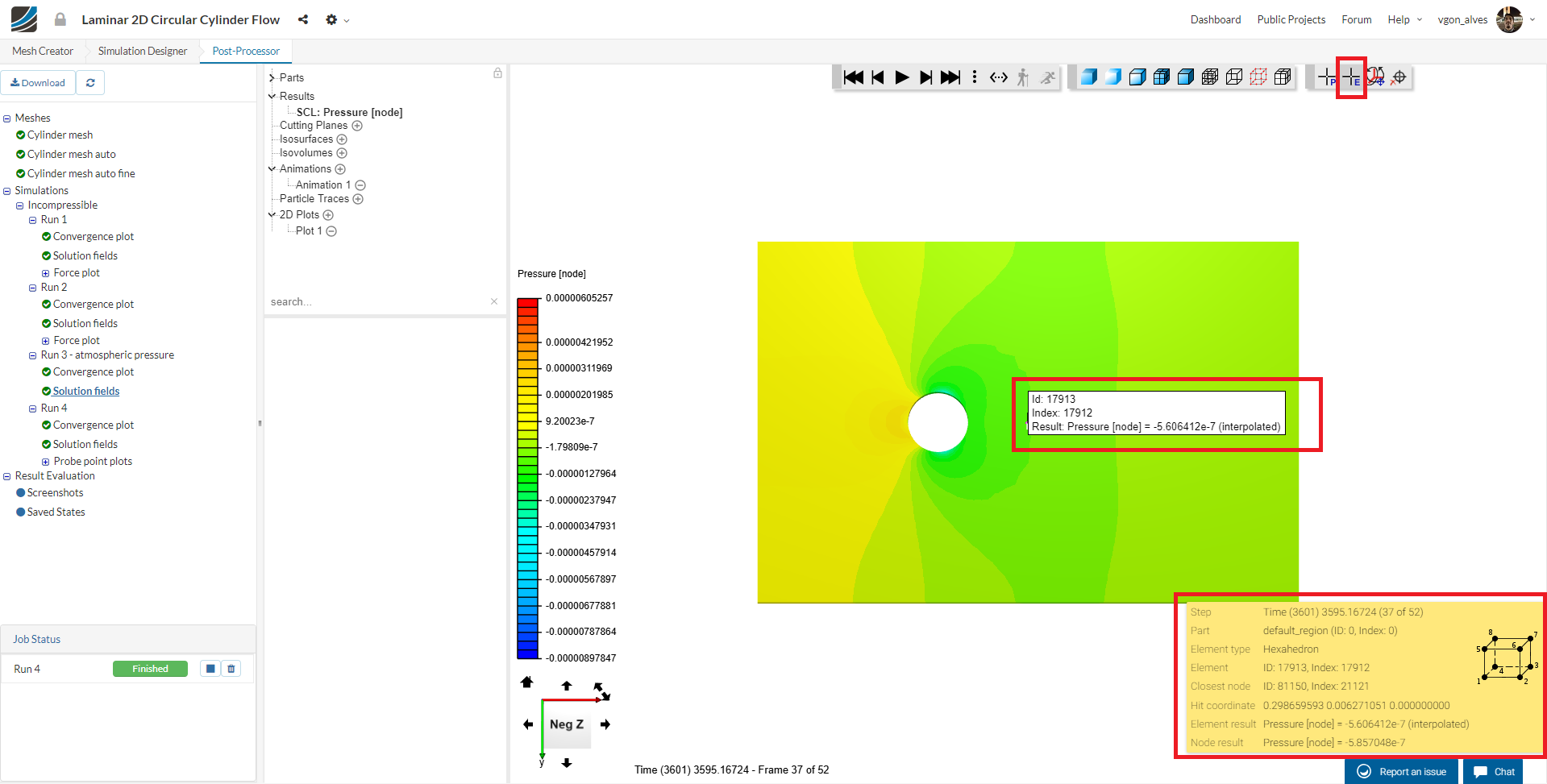

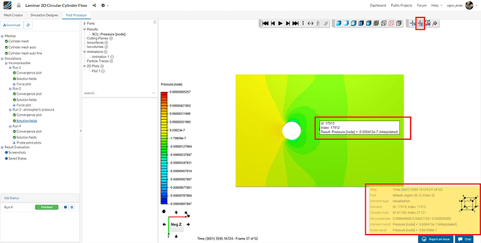

You can also use probe points to get informations in the nodes. Use the Select Element tool and click wherever you want:
Hope this helps :smile:

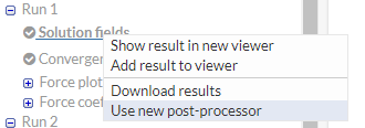

Hi @vyvo,
For the explanation above you do not need to download Paraview, just need to click with right button on Solution Fields then click on Use new post-processor as the example below.
Please, let me know if everything is clean :smile:
