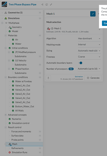

Just curious how one is to find what is missing. It says I need to complete set-up, but I can’t see anything I have not configured.
Thanks,
Stephan
Got it! I was using two phase flow (air/water) but only defined the inlet flow rate of the water. I forgot to specify the air fraction. I changed the inlet definition of the air to a fixed pressure and it worked. Running the mesh now.
