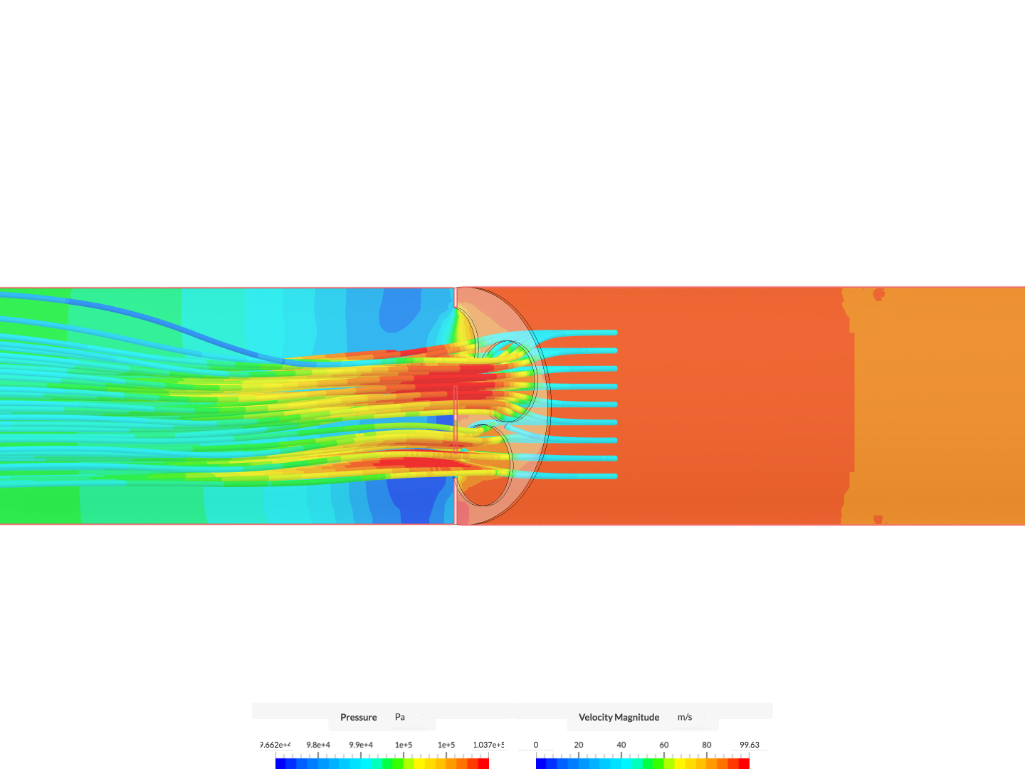

I tried to simulate the flow through a perforated plate. At first I calculated a plate with one big hole for a specific pressure loss. Then I divided the one big hole in four equal holes to see the difference between those cases (and tried to show the results as a simulation). In the last step I want to put another an exact copy of this plate on the top of the other and twist them together to raise the pressure loss in steps. But the results for one plate are not making any sense for me. I see no flow through the plate. Is there something with the CAD or what is wrong?

It is really important to extract the flow region at the beginning of the simulation. The result of this operation is the domain you will use for the analysis. You can have a look at our Flow Volume Extraction guide here: How to Create Flow Volume Extraction? | Knowledge Base | SimScale
I also created a Closed Inner region here: https://www.simscale.com/workbench/?pid=4427562458669050652&mi=operation%3A7%2Cgeometry%3A1&mt=GEOMETRY_OPERATION
I suggest you give it a try too :slight_smile:

Thank you for your helpflul respond! It looks quite more accurate now. I tested it by myself but unfortunately I did not find the “face370” for the closed inner region.
