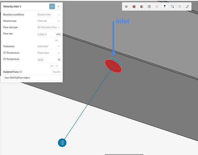

I’ve just opened your project and the Particle Tracing filter seems to be working fine from my perspective:
Keep in mind you can’t select the outer face for the filter since you have a velocity inlet on the inner one:
