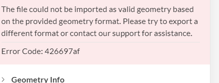

hello! I have been doing my simulations in simscale without any problem importing from solid edge. However, this last time I have imported a solid edge assembly and turns up with the error code 426697af, saying the file could not be imported as a valid geometry. The previous assemblies I have imported and simuated were not that big, dont know if that could be the problem…
I have tried importing a STL file as well but is it taking forever, could someone help me?

Hello, have you already tried exporting the file from SolidEdge in one of the other supported formats? For instance, Parasolid, step, sat, iges, etc.
Stl files tend to be the worst option, as far as simulations go (unless you are running PWC or LBM).
