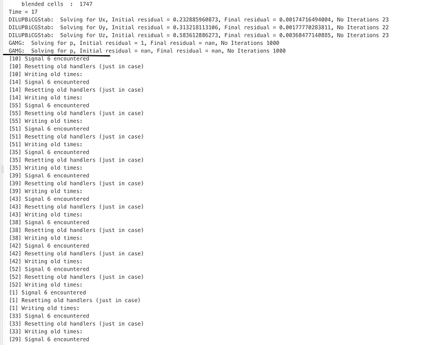

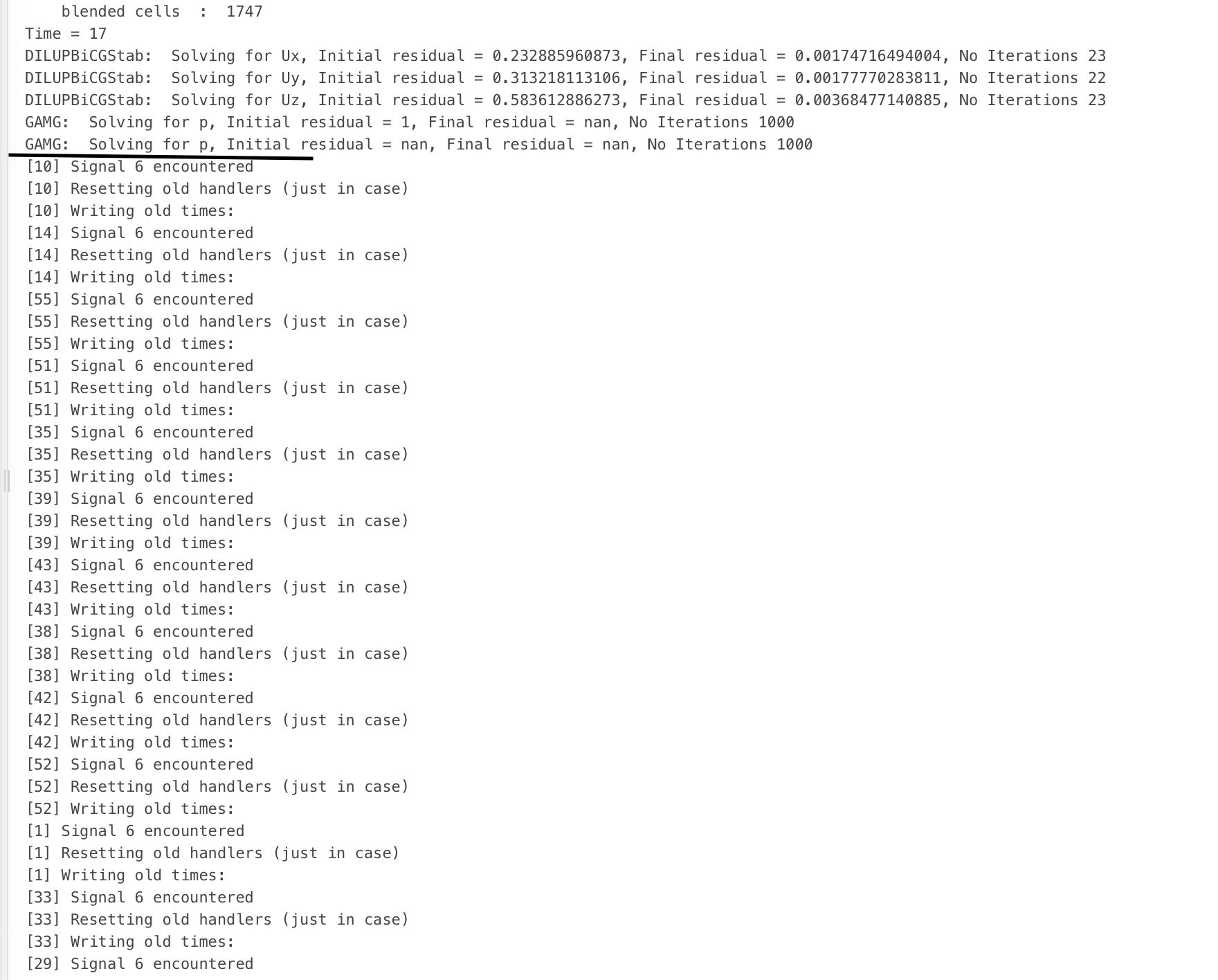

Also I am not able to view the project. I wanted to look at it because I wanted to view the simulation log. On my simulation there is something in the log I have never seen before (Image below). Everything below the black line in the image is stuff I have never seen in my simulation logs before.
