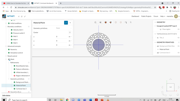

if i make the material point of my tire under geometry primitives the same as my centre of rotation does that make my mesh and simulation more stable or less stable
this is my figure
Hey there!
The material point has not any effect on the stability of the simulation.
It just helps the meshing algorithm to find out where the fluid region is located. Have a look:
