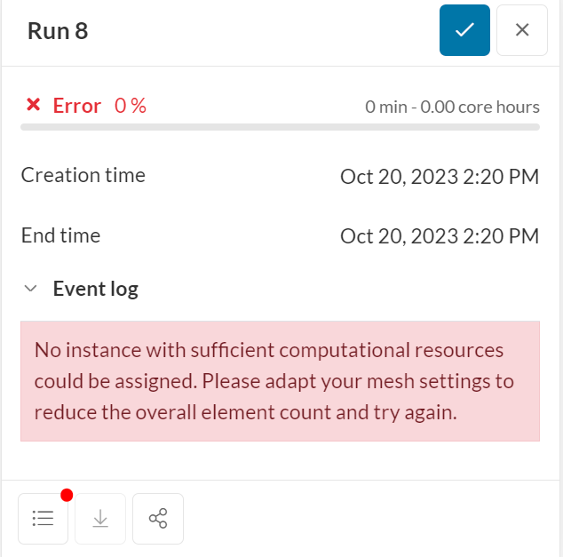

No instance with sufficient computational resources could be assigned. Please adapt your mesh settings to reduce the overall element count and try again
hey there,
Im trying to simulate a new iteration of our car, but I keep getting the same error. I´m using the same mesh options as usual, so I dont understand why this error occurs.
Please help: https://www.simscale.com/workbench/?pid=2629275155751436389

unfortunately not, still getting the same error.
still not working, does anyone know the fix to this issue?
Hi there,
Can you share the screenshot of the error? As @anon77415598 said, the new mesh and corresponding simulation is working well. So we cannot see any errors The screenshots will help :slight_smile:
We are looking into improving this error message too (I’m sure we could be more helpful).
I’m not even sure it’s OK that it blocks you from simply trying to simulate anyway.

even with the coarser mesh its still failing

I deleted the BC, tried it, but the outcome sadly remains the same :frowning:

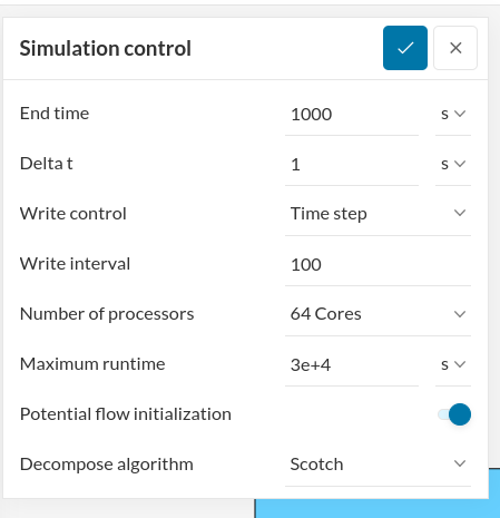

@StrohmUndSoehne ,
there is just one thing that needs to be changed, which is changing the “Number of Processors” from “automatic” to “64”:
We are working on the issue that the automatic processor selection has a non-ideal behavior in this scenario as well as reporting a misleading error message, but for now the above change should unblock you. Also for future cases where you get the “no instance with sufficient computational resources” error, you should try first with manually selecting 64 cores (or whatever is the max number you can with your license).
