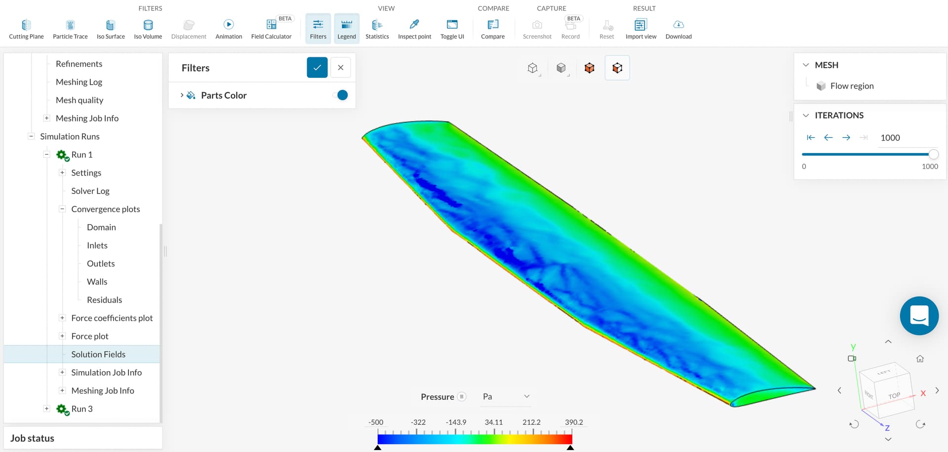

While im trying to view the pressure distribution on my wing, in the solution field, it gets solid red like to be the same pressure all of the wing. Can you help me?

Hi @kkatsaflioglou , by default the viewer scales to the maximum and minimum pressure values. in your case, the minimum was -ve in the order -1e4. If you rescale the results, you see more like what you expect:
However, that doesn’t mean everything is ok, if you get pressure values this low, the most likely scenario is that your mesh is either too low quality or too coarse, I would suggest adding some additional resolution as per best practices.

But how can i rescale the resaults?
Hi @kkatsaflioglou just click the values at the upper and lower bounds of the legend and type what you need :slight_smile:
