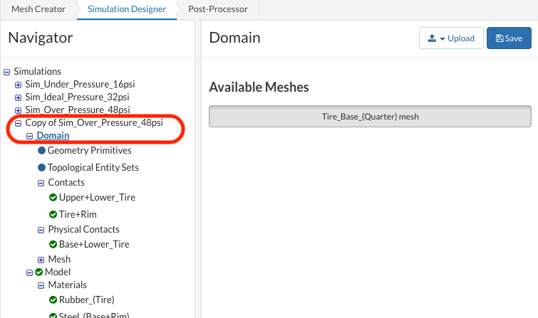

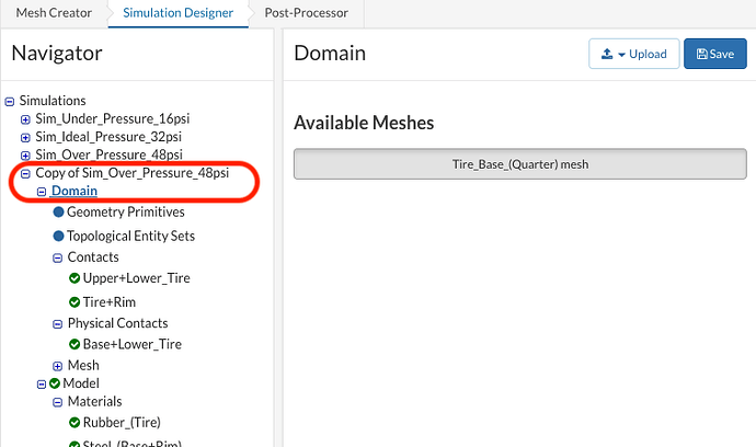

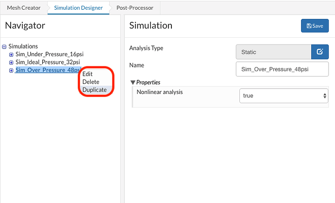

\underline{\textbf{1. Right-Click to duplicate existing simulation}}
\underline{\textbf{2. Choose existing other meshes}}
