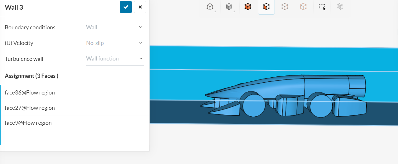

@Apollo_Racing: It seems you did not look at examples of successful simulations. Your current geometry is a culprit. When I’ve seen it, I thought it was a clogged vacuum clear tube simulation.
You simulation domain is too tight.

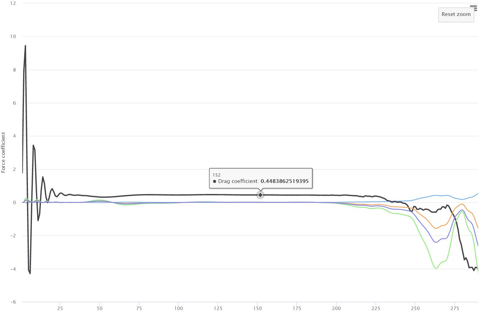

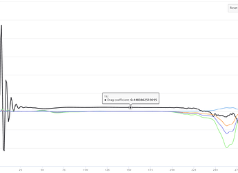

You can notice, that Force and coefficient plot looks quite good till ~200 simulation steps:
Running it for more, is a waste of resources. You should stop the simulation in that case, mend the setting and restart a new one.
