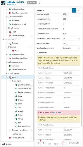

i am trying to create a mesh for full car simulations of my FSAE racecar. but i have been getting this error constantly:
“The mesh could not be generated. Increasing the mesh fineness or adding local refinements to geometrical details potentially fixes this issue. Please contact our support for further assistance.”
this error is only when i mesh for full car. i am able to successfully mesh the half car model and even run simulations on them.
my meshing log after the error is encountered and meshing is stopped is like this:
Writing mesh to time constant
Wrote mesh in = 68.13 s.
Layers added in = 4473.32 s.
Checking final mesh …
Checking faces in error :
non-orthogonality > 70 degrees : 0
faces with face pyramid volume < 1e-13 : 0
faces with concavity > 80 degrees : 0
faces with skewness > 4 (internal) or 20 (boundary) : 0
faces with interpolation weights (0…1) < 0.02 : 0
faces with volume ratio of neighbour cells < 0.01 : 0
faces with face twist < 0.01 : 0
faces on cells with determinant < 0.001 : 0
Finished meshing without any errors
Finished meshing in = 4633.06 s.
End
Finalising parallel run
this doesnt show any illegal cells. but still the error persists. kindly help me regarding this!
