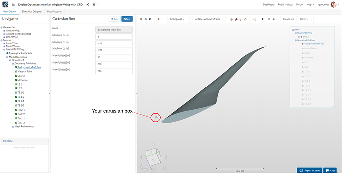

I’ve got the same issue here but I’ve checked my model and I think it’s watertight.
https://www.simscale.com/projects/Foster/design_optimization_of_an_airplane_wing_with_cfd_2/
Hi @Foster!
Let me tag @jhorv_th & @vgon_alves here who might help you out with that. I can have a look at your project in the evening.

Hi @Foster!
First thing I noticed is that the geometry is not split and consists of just one single solid/face. Can you please use the split operation for the layer inflation to be properly established? Try that and let us know if the meshing process was successful.
Hi everyone,
Sorry for delay. Please @Foster make sure that your geometry is with the correct dimensions, look:
  1. Aircraft wing diagonal length = 19 [m] :heavy_check_mark:
  2. Aircraft blended winglet diagonal length = 21 [m] :heavy_check_mark:
  3. B787Wing diagonal length = 34991 [m] :x:
The third geometry (B787Wing) it is too big that the boundary box is not big enough for it, look:
Please, consider to fix it in addition what Jousef said above and let us know if it works :smile:
