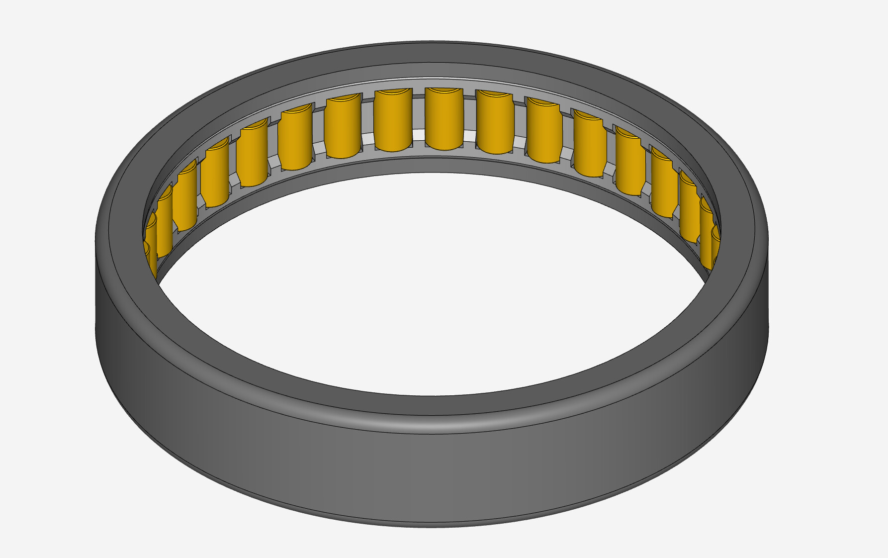

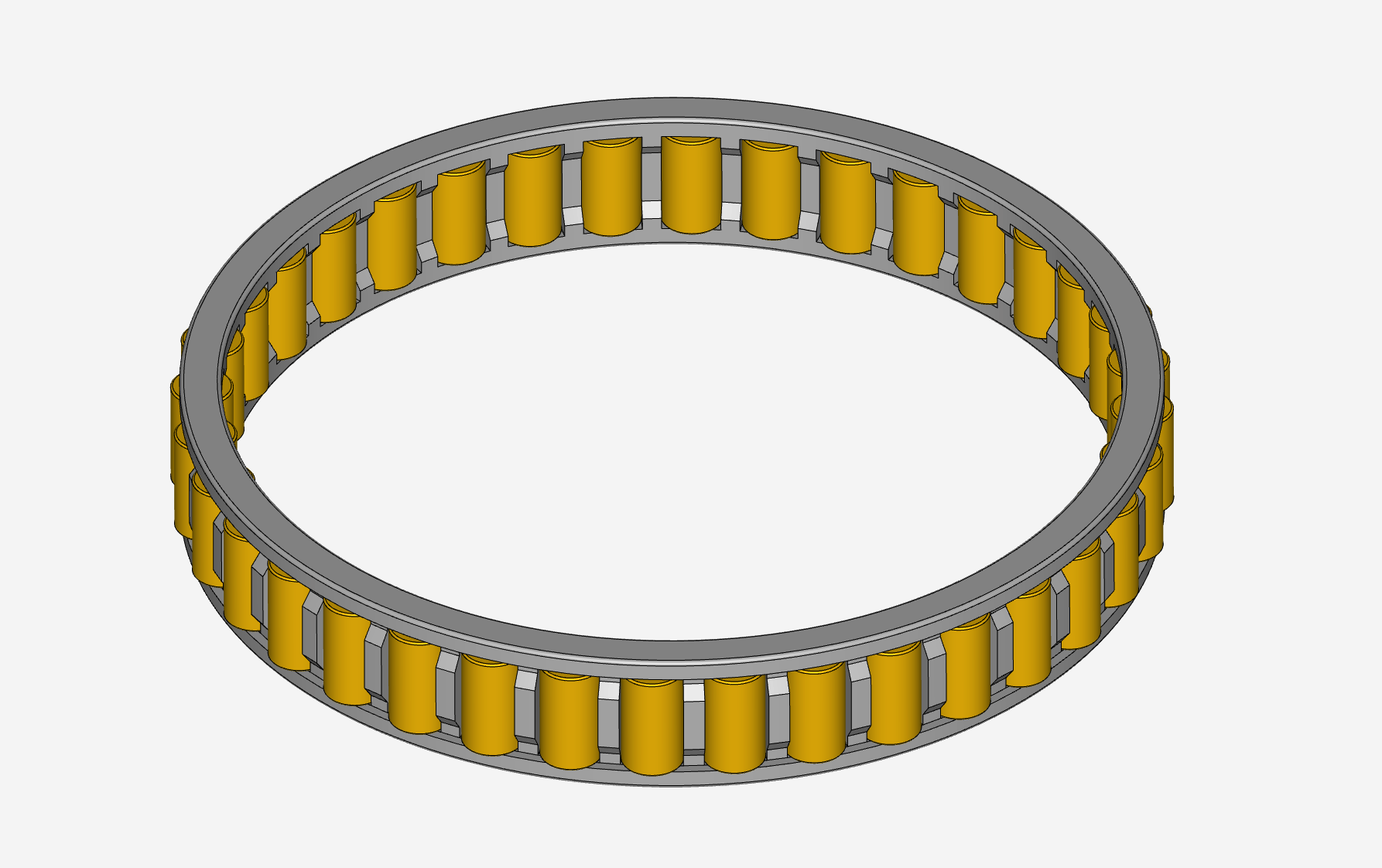

Could you give me some guidelines on tackling interference issues?
The model was initially made with Siemens NX, i used datakit to make the .prt files to .sldprt and .sldasm

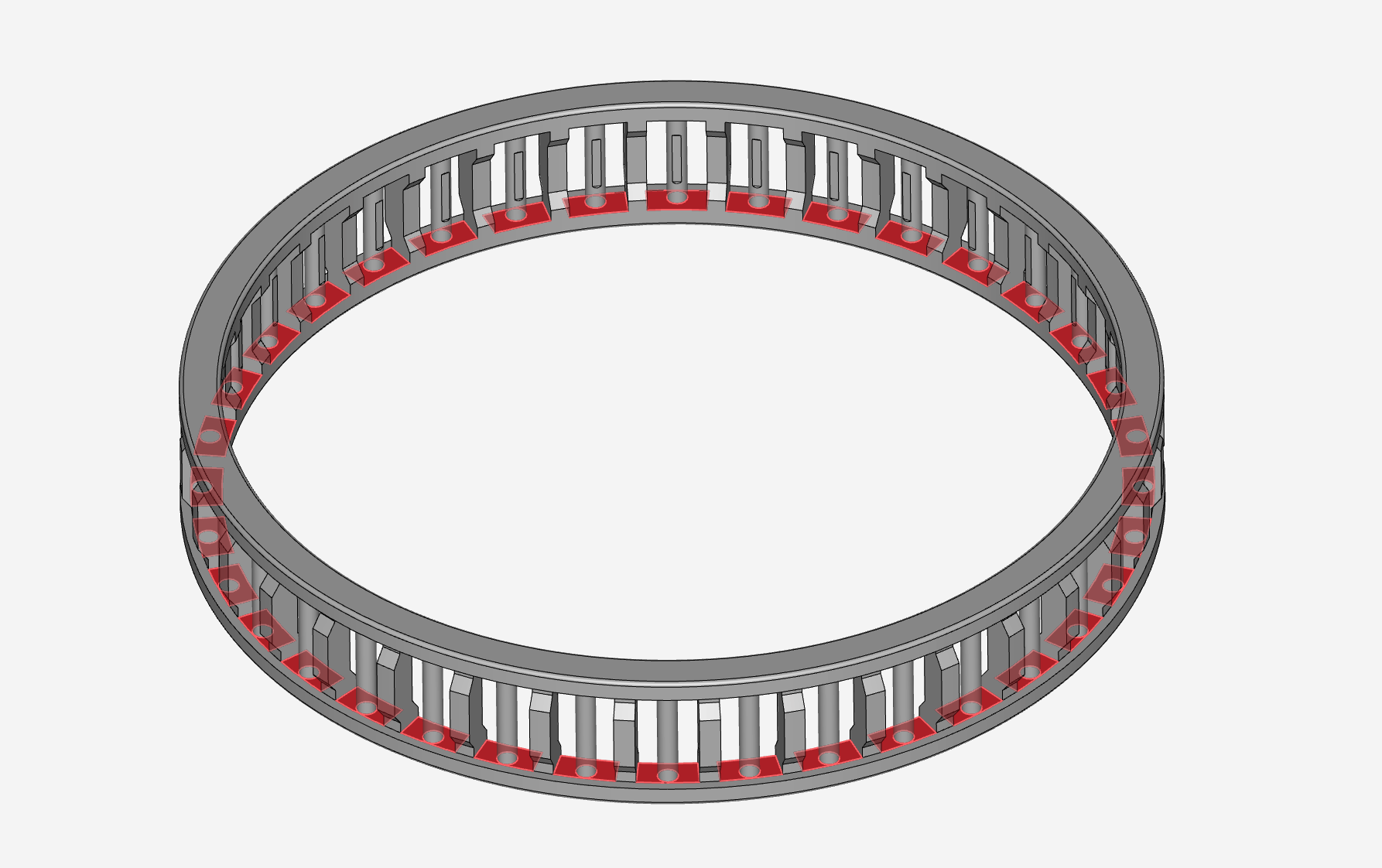

Thanks for initial helping, the fact is that there is actually a self intersection happening on a single solid volume.
The problem is probably located in the edges that host the rollers of the bearing.
Could you please any tip/hint for tacking the issue, I am working on the project as well

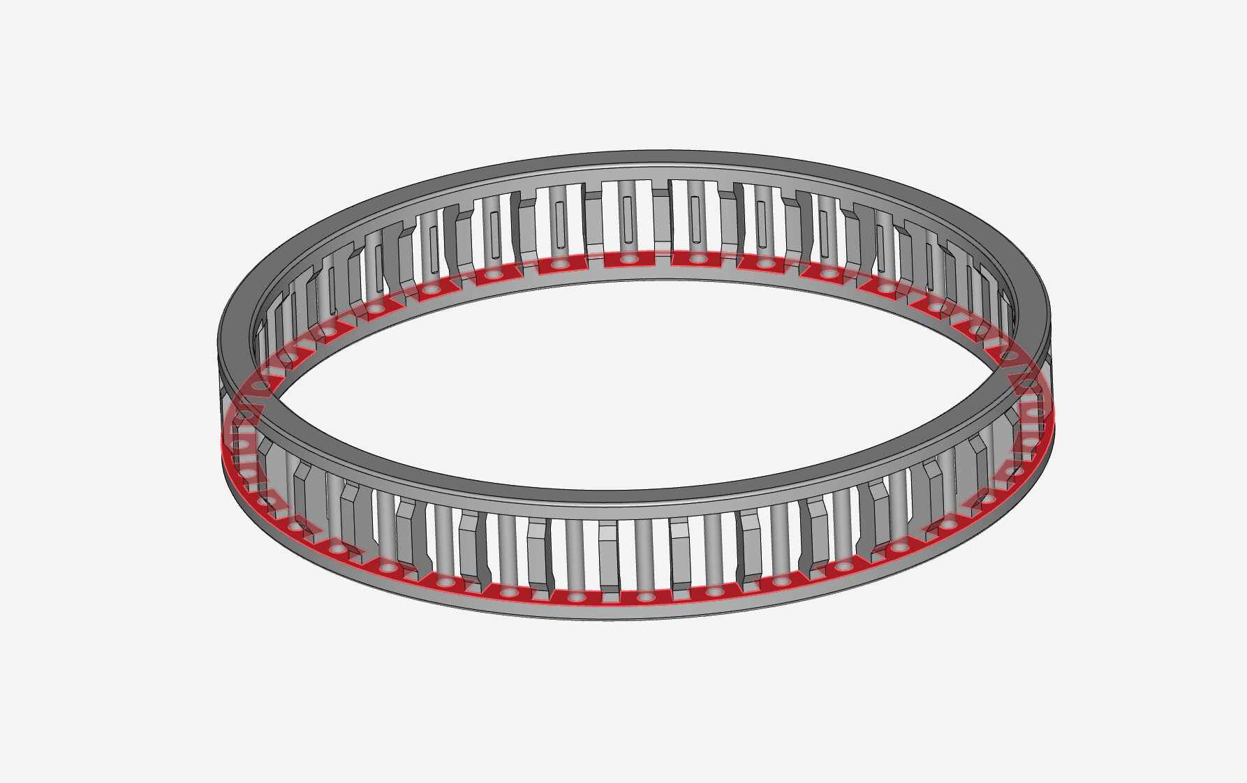

When selecting a single part of the lower edge all the surface gets selected.
On the other hand when i select a part of the upper edge only the corresponding surface gets selected.
Probably a faulty boolean subsract effort on the CAD software before importing to simscale.
It would have been prefered if the issue got solved in simscale environment
Hi @Zaff_Zaff,
I see - this must be an issue with the CAD modelling in this case. As I’d mentioned in my previous post, the best approach is to start off with simpler shapes and build on complexity as you progress. This would make it simpler to troubleshoot the issues which appear since we’d be able to pinpoint exactly where they’re coming from.
