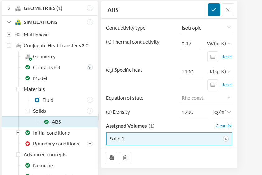

If you want to define properties for the occupants as well, you would simply not delete the occupants after generating a flow region, which would allow you to define them as “solid” materials with a conjugate heat transfer v2.0 study. This is, again, not a common approach.
