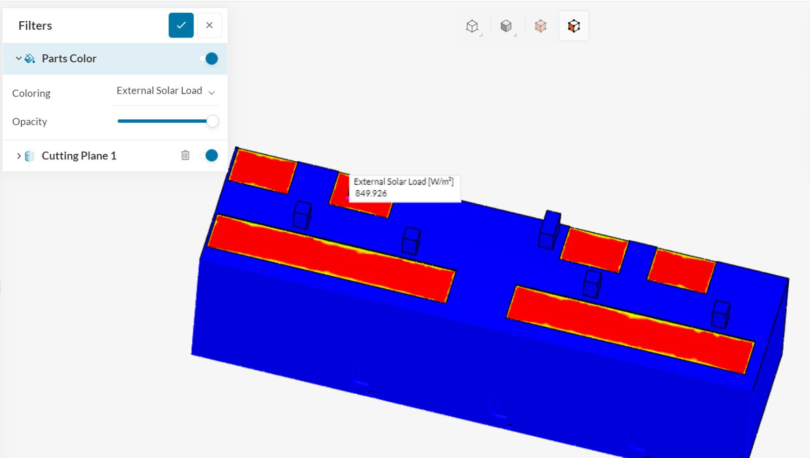

Here is the thing: those red region square in the picture, is the cooling panel. In the original design, that is a cooling facility, which is set to be a cold region for about 18℃.
Since I need to consider it absorb the heat through radiation , the radiation function is open.
However, I want to consider the solar load now.
In the real life , there are several floors above the model. It will block the solar radiation above. But in the simulation ,the sunshine is been absorbed by the cooling panel 100%, makes it with a very high temperature.
I want to ask if there is a way to add another layer, to block the solar radiation above.

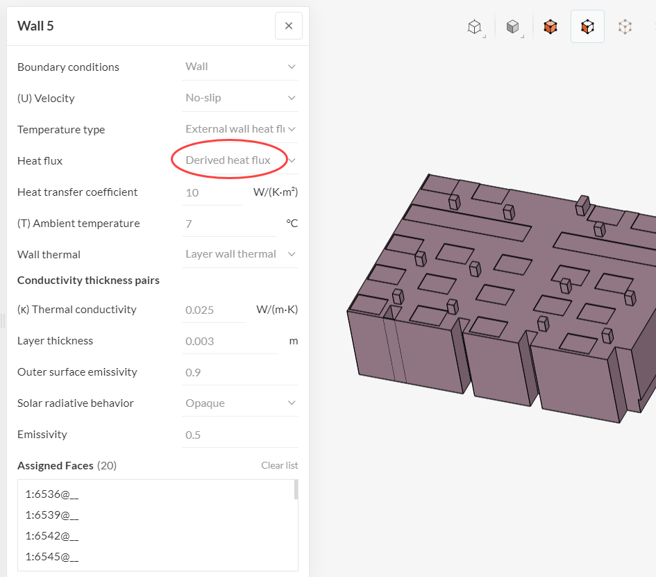

The only wall boundary condition that is affected by external solar load is a “Derived heat flux” boundary condition (doc page). Is there any chance to set those boundaries with any other temperature configuration?
Hi, that boundary is designed to absorb heat (but from internal the room instead of the solar) and the whole simulation is about to get its energy absorption So i dont think i can do that.

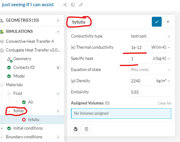

Hi Weixuan,
I saw the recent post from @RicardoParis which sounds like a possible approach to the issue and then saw the comment about “i only saw concrete, i didn’t saw insulative material”.
So I did some research to assist.
I copied the project SPACE by weixuan_yu | SimScale and looked at the solid materials available. You are right about concrete being available and there are other materials that have some insulating ability. However, you can create your own New special material and change the properties to suit.
As you can see from this image, my New special material is called ‘tytutu’.
It has unusual properties, so you can create your own specific insulating material :slight_smile:
I also confirmed this ability to create any New material, via the Simscale document, link attached below.
Hope this helps :slight_smile:
