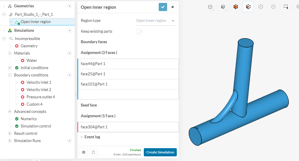

Hi, i’m trying to run a simulation on this T pipe with an extra little curved path:
When I try to run a simulation, I get these errors:
Multiple boundary condition assignments for the following entities: face304@Part 1
and:
No material assigned.
I think it wants me to define the flow rate of the curved section, but that is unknown, I was expecting it would be just one of the things the simulation would show.
Thanks for any help :slight_smile:

I went through the tutorial a couple of times, and got the tutorial working properly.
That helped me fix the velocity inputs on my simulation (well I think they are ok now) but it still has one of the errors:
I’ve tried lots of different boundary conditions for the curved link but none helped :confounded:

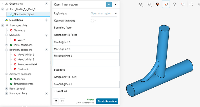

Hey,
Make sure to extract the flow region of your model. Since you are interested in the water that is going through the pipe, your model should only contain the flow region.
In your case, it would be an “open inner region” operation. Have a look here for more information: How to Create Flow Volume Extraction? | Knowledge Base | SimScale
After you obtain the flow region, the set up will be very similar to tutorial 2 (the pipe tutorial).
Here’s the result/set up of the open inner region, in case you run into issues:
awesome, thanks for your help :slight_smile:
