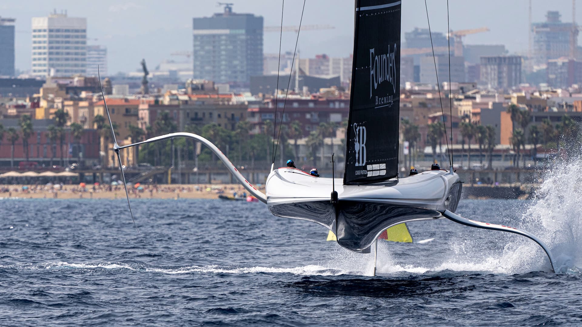

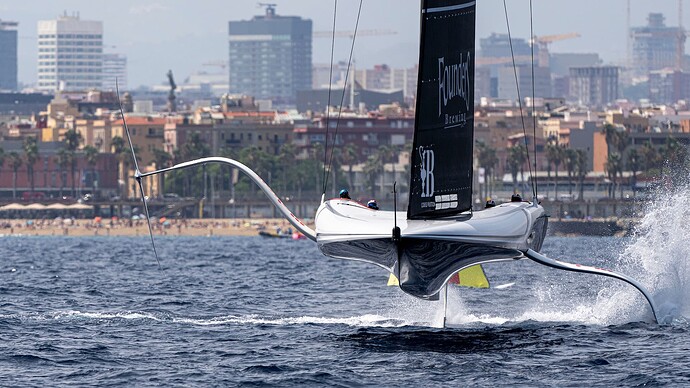

Hi, I am trying to simulate an ac75 hydrofoil section (5mm thick profile) and would like to do such simulation in order to visualize water cavitation. what simulation should I use? multi-purpose or multiphase? And what boundary conditions should I set? Thank you.
