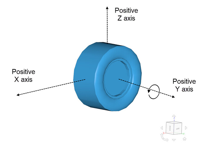

For the rotation axis, you must use the right-hand rule.
source
For example, here the wheel rolls towards the positive X-direction, so according to the right-hand rule, the rotation axis is the Positive Y-axis:

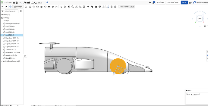

So I created an OnShape account, but I dont know how to find out the center point of the wheel. For me it just shows the “Fläche” which is german for Area

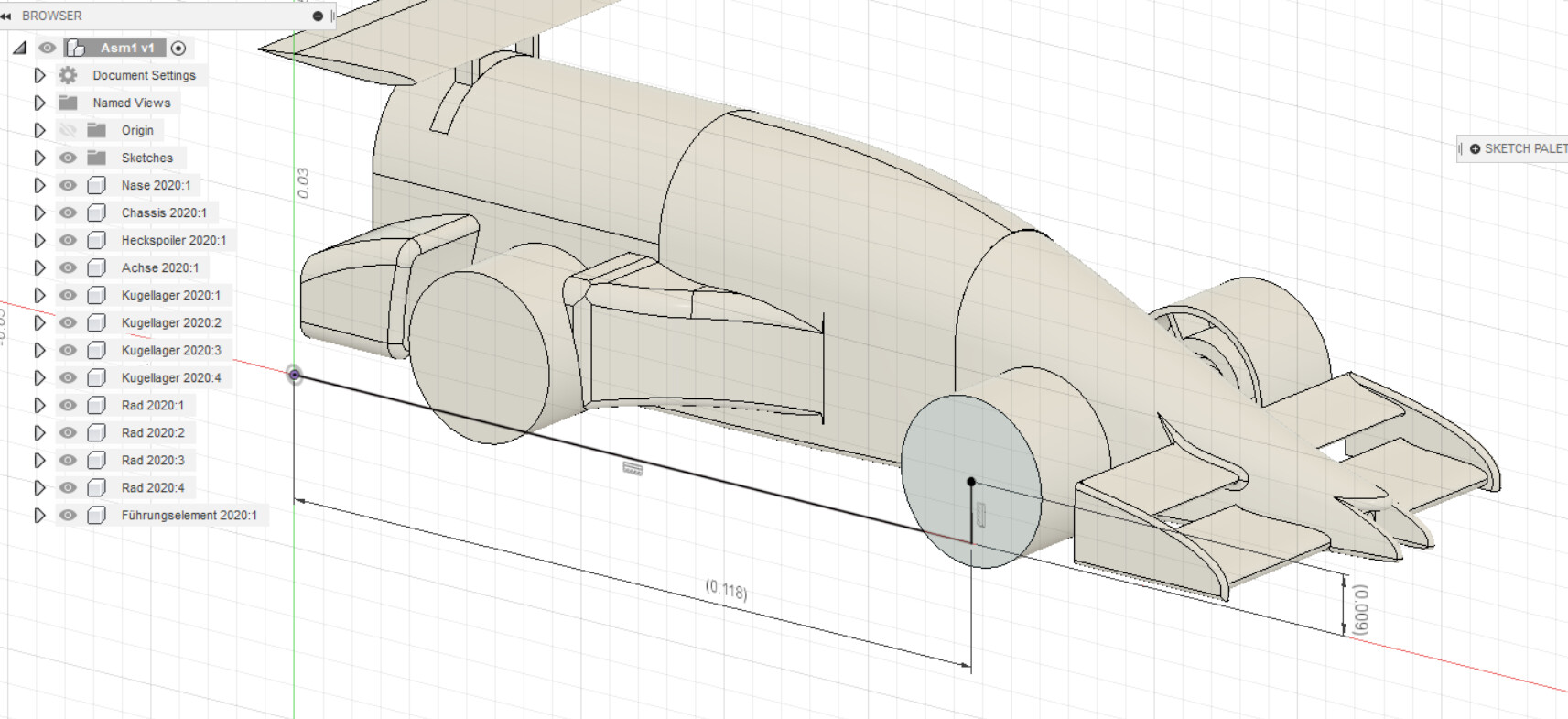

There are multiple ways to know the absolute position of a point; you could use the cursor coords, dimensioning. inspection methods like measure in Autodesk softwares etc.
Anyway, I used dimensioning-

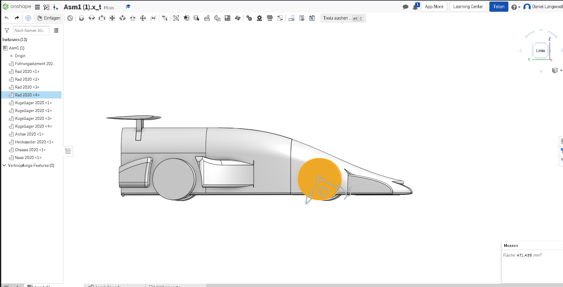

Following the car tutorial (fig 23, more especifically), the idea is to click on an edge of the wheel, and then on the ruler icon:
This should open one window with additional information, regarding the center coordinates.

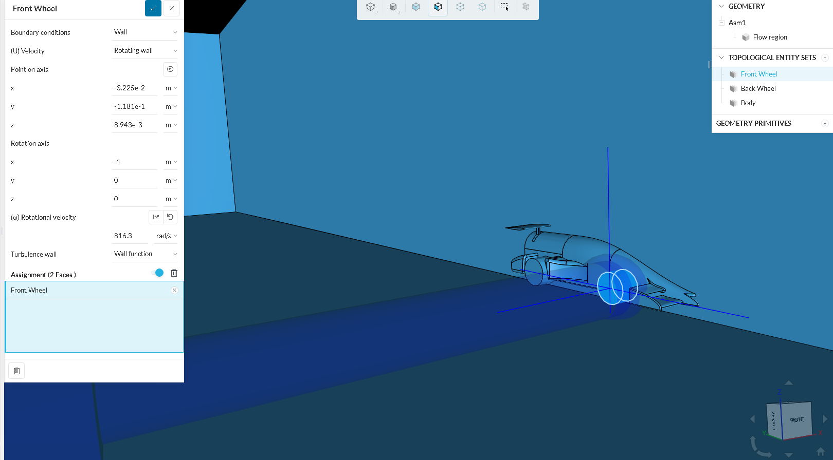

Ohhhh ty, I didnt know I had to click on the edge of the wheel. I think I got that now. Does this look like the rotation axis and point are set-up correctly?
