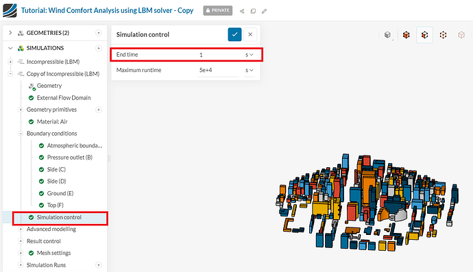

1. Under ‘Simulation control’ > 'End time ’ , change value to 1 sec. This will generate the mesh and stop the solver.

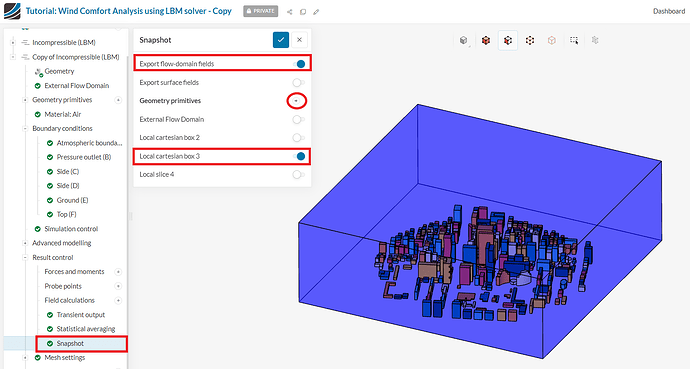

2. To output the mesh , you need to manually add a ‘Result Control’ > ‘Snapshot’ output for a cartesian box region where you want to visualize the mesh. This cartesian box can be the entire model volume space.

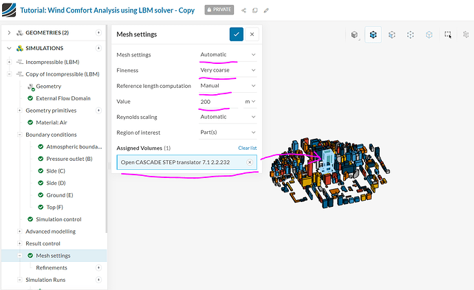

3. Use the following mesh setting as a good reference to generate a very coarse mesh to test.
** - Note: with a reference length of 200m , a very coarse mesh will give a minimum cell size of about ~ 0.78m for the selected region of interest parts or space.**

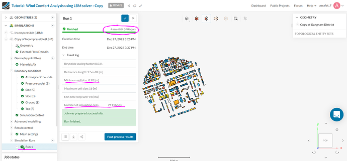

4. Start a simulation run (ignore the warning message). This will take only about 1 gpu hr and once the run is finished you can check the mesh details as follows:
- The overall mesh size and minimum cell size are displayed under the ‘event log’.
- Try to keep the ‘number of simulation cells’ less than 90 million at max. Typically, 20- 60 million is okay.

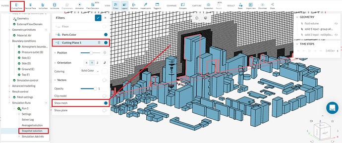

- To view the mesh , click on the ‘snapshot solution’ and create a cutting plane. In the cutting plane option , turn ‘on’ show mesh button. You can move the cutting plane and change orientation/location.
