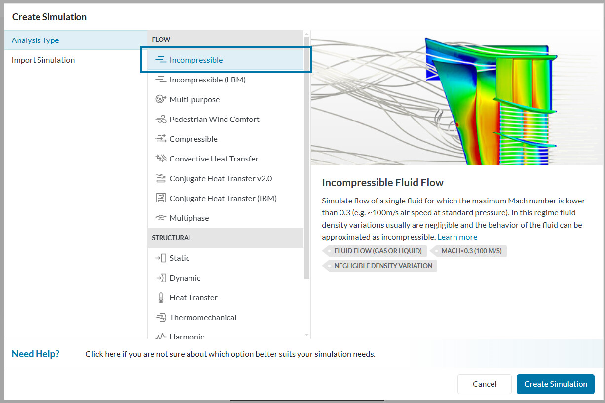

Hi MrSchramm,
Thanks for reaching out to us on the forum. You are right, it is trying to use GPU hours instead of CPU because the simulation you are trying to run is an ‘LBM’ simulation. LBM uses GPU hours. The plan you are on currently does not include GPU hours and therefore cannot run a simulation with LBM. Please use the regular incompressible simulation instead and things should work just fine!
Satvik
Hi there! As an additional comment on @shenoy’s reply, there is an option import for STL files called “Optimize for LBM / PWC”. When it’s toggled on, the CAD will be imported as a facet only geometry and will only be fit to be used in PWC/LBM simulations - make sure it’s toggled off!
