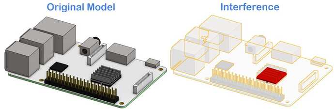

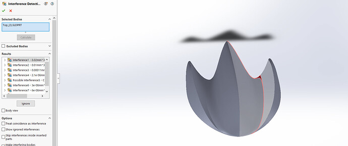

The issue is probably the fact that the solids are overlapping with each other:
Is it possible that you create a single solid body by merging all the parts?
Have a look at this page for more insights:
