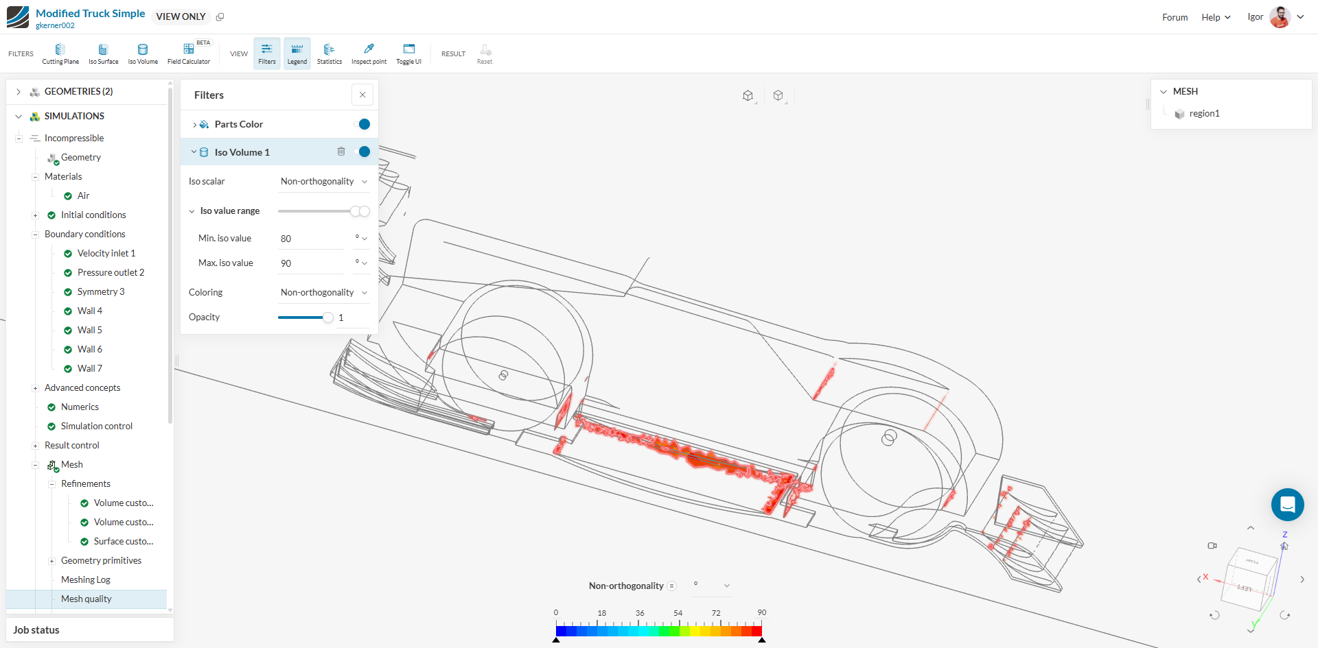

Hi @gkerner002
Inspecting the mesh via the Mesh Quality viewer, I see many highly Non-Orthogonal cells:
Please take a look at this recent forum post with a very similar issue: Incompressible Fluid Flow For Car
