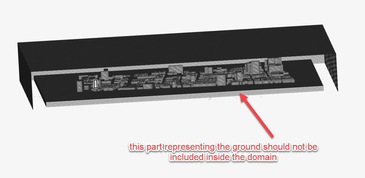

By the way, have you considered using the standard mesher instead of the hex-dominant parametric? Have a look at this project for example:
It uses an Enclosure and the standard mesher. Also, make sure this part that represents the ground is left out of your domain:
I suggest you revise your project and set it according to the link provided, and if the issue insists, make sure to reach out again :slight_smile:
