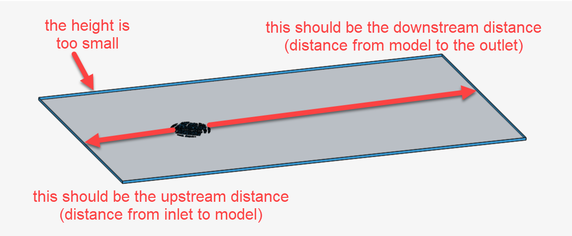

However, my personal suggestion is that you set the domain sizing according to Figure 5 here first: Aerodynamic Flow Behavior Around a Vehicle Tutorial | SimScale Of course you do not have symmetry, so you will need to extend the domain to both sides. Make sure to increase the height too.
