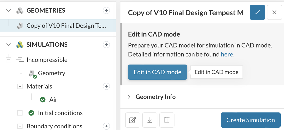

1 - Select "Edit in CAD mode"in your geometry.

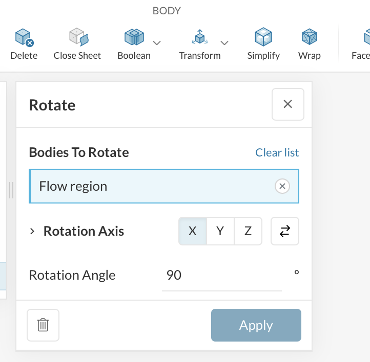

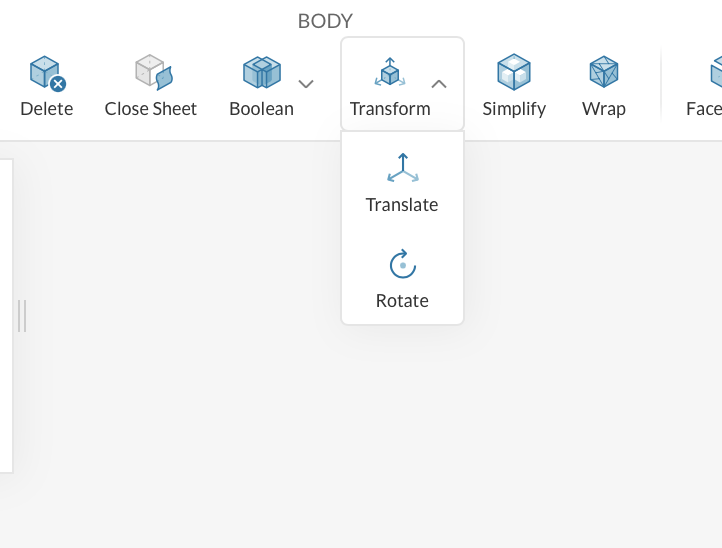

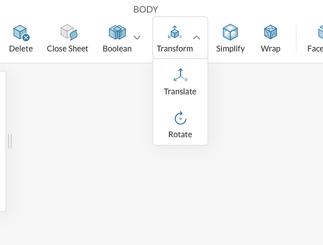

2 - Once in the CAD edition mode, select “Transform” and then → Rotate

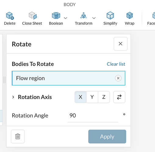

3 - Select the entire body that you want to rotate and the right axis related to, and then set the angle. In your particular case (upside down), you need to set a first 90deg rotation, and then create another rotation operation for the same axis setting up 90deg again.
Then your geometry will rotate for the right position.
