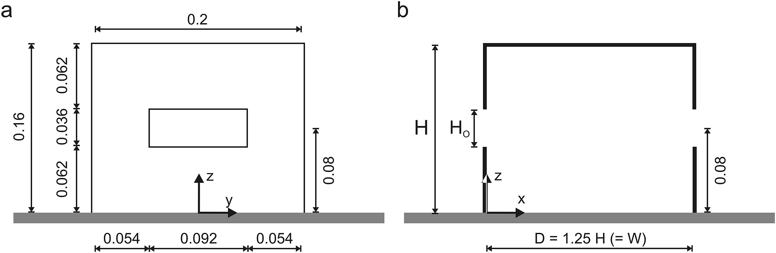

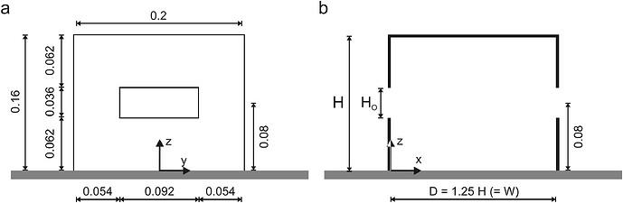

Fig.1 Building geometry. (a) Front view. (b) Vertical cross-section. Dimensions in m [1].

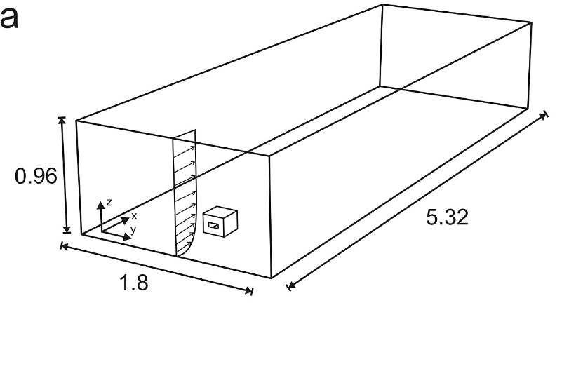

Fig.2 Computational domain [1].
U_H is the velocity at building height. Other parameters can be found in attached paper [1].

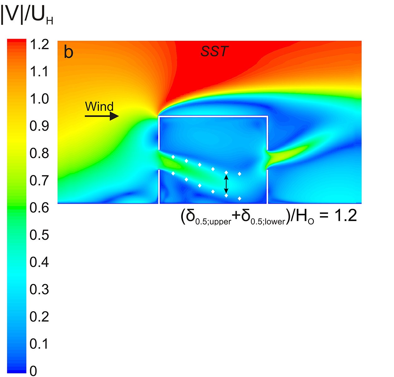

Fig.3 Velocity plot at mid plane of the building [1].

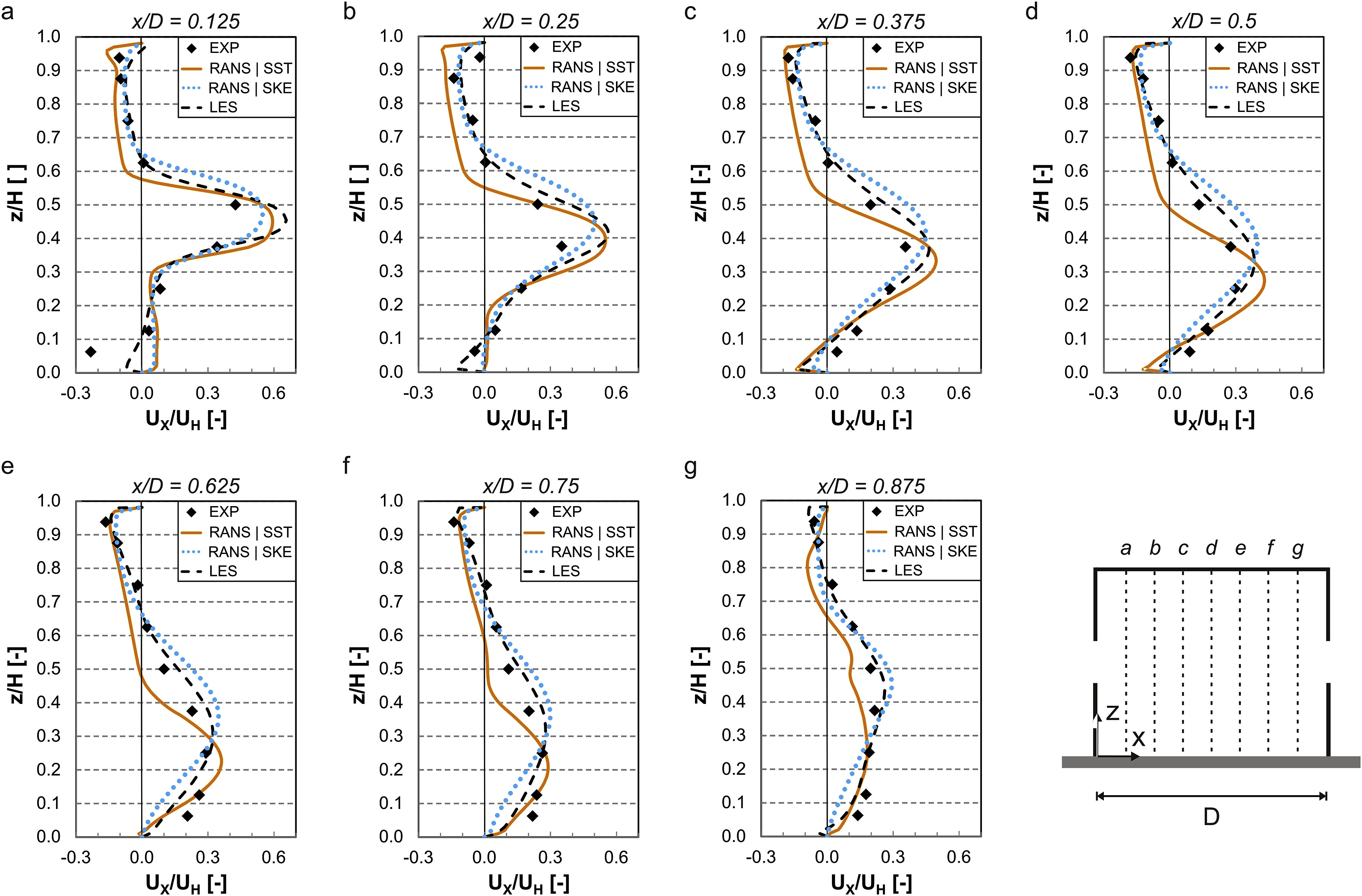

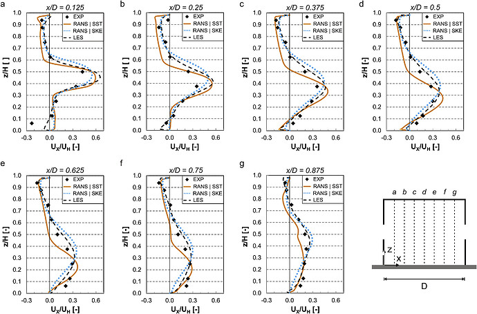

Fig.4 Comparison of dimensionless mean x-velocity (UX/UH) obtained with LES (dashed line), and SST k-ω model (solid line), and with wind-tunnel measurements (◆), along seven vertical lines inside the building in the vertical center plane (y/W = 0). (a) x/D = 0.125; (b) x/D = 0.25; (c) x/D = 0.375; (d) x/D = 0.5; (e) x/D = 0.625; (f) x/D = 0.75; (g) x/D = 0.875.
